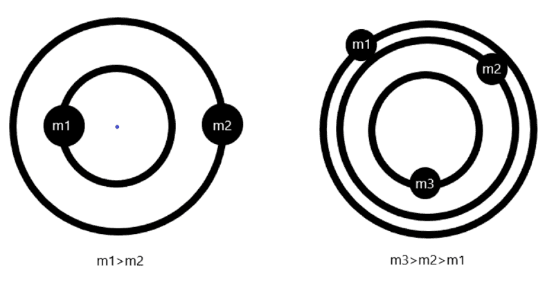

Imagine the 3 body problem with identical masses, all orbiting their barycenter in a circle.
The question is what each bodies distance to the center would be if they were different in mass, but all still orbiting in a circle, now of course at different orbital radii. So a non-hierarchical system.
I have attempted to translate the principles of the binary system over, where a mass 5 times heavier than the other would be five times as close to their shared center, but have had no luck so far.

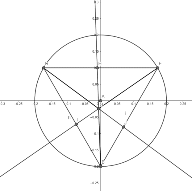

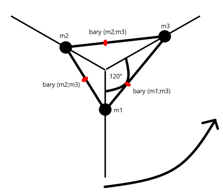

Tl;dr: Here is as far as I have gotten in my failures, but my stomach has now also given up and I cannot work on this until that's fixed. We will see how well I can keep up.
I have been trying to do this since but have not managed to get it to work. I tried to treat it as a 2 body problem with the barycenter of the opposing bodies as the second mass, then placing the masses in such a way as to make their relative distances appropriate at a separation of 120° around the rotational center, but I have not managed to make this work

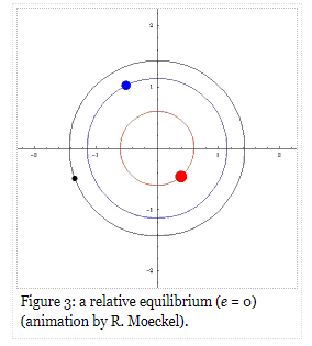

http://www.scholarpedia.org/article/Three_body_problem (homographic solutions, figure 3)
Shows an animation of 3 bodies in equilibrium, basically as needed. The interesting thing here is that they seem to be in formation as an equilateral triangle (so with the 120° separation), BUT they are rotating around some other point. So I tried having them orbit their shared barycenter:
But I have also not been able to get this to work. Maybe some other center is needed or I am just not calculating the orbital periods correctly, since they are not coming out as equal.
(animation by R. Moeckel).
Yes, Lagrange showed that this must be the case (I have replaced the image you posted with the animated version).
Exy said:
BUT they are rotating around some other point [than their barycentre]
What makes you think that? Newton's first law requires that they can only orbit the barycentre, and this is how they are depicted (note that ## m_{\text{red}} > m_{\text{blue}} \gg m_{\text{black}} ##).
