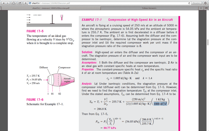

So this is the question I am working on as shown in the attachment.
I got stuck in the part that I highlighted, where they divided the Dynamic temperature by 1000.
WHY ?
Any help will be appreciated,
Thank you.
WHY ?
Thank you.
It's not that the dynamic temperature is divided by 1000. (Notice: there are units attached to the 1000). You have to convert 1 kJ (= 1000 kg-m[itex]^{2}[/itex]/s[itex]^{2}[/itex]) into its equivalent base units so that you can calculate the rise in temperature due to the velocity of the air.
