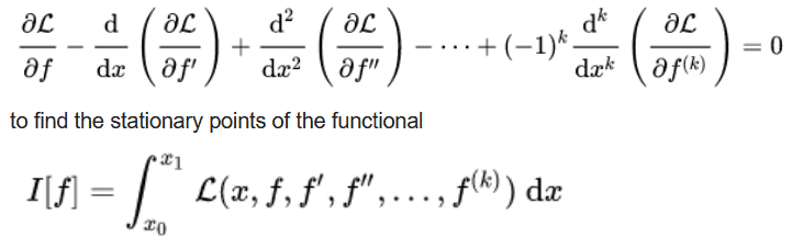

In Wiki's article on the Euler-Lagrange equation , under "Generalizations">'Single function of single variable...', there is an equation (stated in main text). Is there a standard name for it? Some Russian authors call it the Euler-Poisson equation.
In English, does the equation
have any standard name besides (generalization of) the Euler-Lagrange Theorem? I have seen the designation "Euler-Poisson Equation" used by the Russian mathematician Lev Elsholtz way back in 1956 repeated in recent Russian webpages, but am not sure whether this would be recognizable (perhaps with a footnote?) by English-speaking mathematicians. (Not to get mixed up with either the Euler-Poisson-Darboux Equation or the Euler-Poisson Integral.)

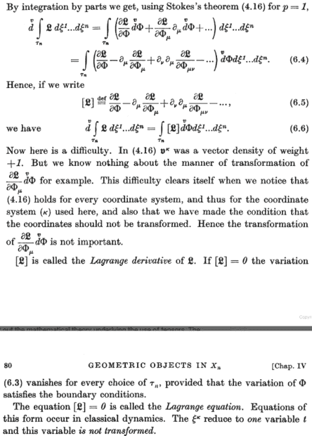

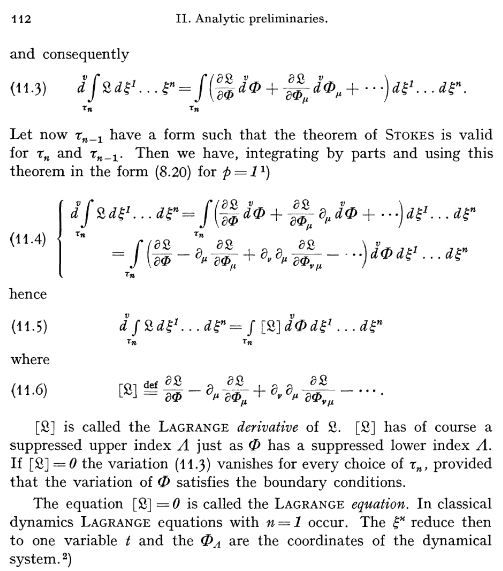

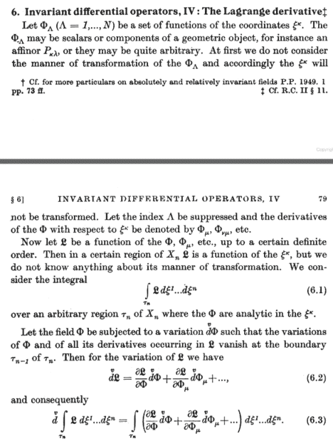

In Schouten's Ricci Calculus (Springer) and his Tensor Analysis for Physicists (Dover),
he refers to the "Lagrange Derivative".
previews from Google Books... search for "lagrange derivative"
From Ricci Calculus,
From Tensor Analysis for Physicists,
Thanks very much, robphy. (Sorry for the delayed response.)
(You attached the same excerpt twice.)
Unfortunately, when I googled "Lagrange derivative", I came up empty (i.e., nothing under that title, and, google sending me what was closest, everything was about the Euler-Lagrange Equation).
I am working through the text you sent. Given that I am close to nil in differential equations, perhaps you can answer a couple of questions on it. First,
Wouldn't that make the Script-L a functional?

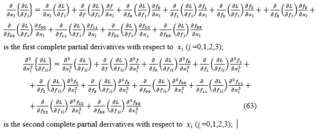

I am attempting to see whether this text would help me interpret the so-called Euler-Poisson equation in where the partial derivatives such as
in the Euler-Lagrange equation are replaced by the "total partial derivative", or "complete partial derivative",
which are defined as follows (Elgots, Calculus of Variations)
Is the "complete partial derivative" here the same as the "total derivative"?
For which situation(s) is the replacement of partial derivatives by "total partial derivatives" in the Euler-Lagrange equation useful/valid? It appears that when one applies this new equation to a Lagrangian, one is likely to get a different answer than the application of the usual Euler-Lagrange equation, so the circumstances must be different, no?
Sorry if the question is obvious, but my level of "diffy-Q" is rather basic. Thanks for any help.

Hmmm... that's odd. I see 4 distinct images, 2 each from the two works (p.111, 112 from Ricci Calculus, p 78-79, 79-80).
with quotes
I've been interested in Schouten's work for a while...
so I recall seeing the "Lagrange derivative"
... and, thus, my response.
Unfortunately, I don't know any more details, except for these terms that may be related to what you seek.
