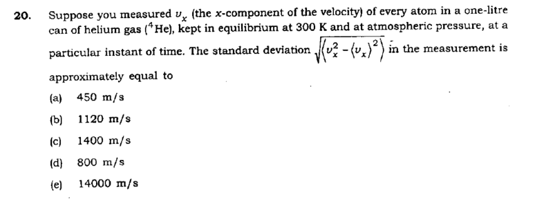

Standard deviation of V_x of He gas

## \frac 1 2 m<v_x^2> =\frac 1 2 k_BT ,
\\ \sqrt{ <v_x^2>} = 556~ m/s ## So, I guess that the standard deviation should be less than rms speed.
So, the option is (a)
## \left< ax + b \right> = a\left<x\right> + b ##
So, ## \left< v_x^2 - <v_x^2> \right> = \left< v_x^2\right> - \left< v_x^2\right> = 0 ##
Is this correct?

I think it your last statement, you are attempting to write ## \sigma^2=E(X^2)-(EX)^2 ##. If that is the case, and you are saying ## EX=0 ## , yes, it is correct. Please put in the mass and temperature so that we can check your arithmetic. For the final answer, the standard deviation, ## \sigma_{v_x}=\sqrt{E(v_x)^2}=v_{x \, rms} ##. Also, the statement of the problem is incomplete. The available answers did not show up.

In the above statement, as ## < v_x ^2> ## is constant, I am taking it out of ## \left< v_x^2 - <v_x^2> \right>## and hence I got ## \left< v_x^2 - <v_x^2> \right> = \left< v_x^2\right> - \left< v_x^2\right> = 0 ##.
But, this way I will always get 0 standard deviation. So, something is wrong with it. Right?

The equation correctly reads ## \sigma^2_{v_x}=<v_x^2>-<v_x>^2 ##. ## \\ ## Editing: This comes from ## \sigma^2_{v_x}=<(v_x-<v_x>)^2> ##. And I think your arithmetic in the OP is incorrect.

## \sqrt{ <v_x^2>} = \sqrt{ \frac { k_BT = 4.14 * 10^{-21}}{m=4* m_p = 6.69 * 10^{-27}}}= 786~ m/s ##
Is this correct?
Likes Charles Link
Yes. Very good. Round that off and (d) becomes the correct answer. See also my edited additions to post 6.

## \sigma_{v_x} = \sqrt{ \left< (v_x - \left <v_x \right >)^2 \right> = \left < v_x^2 \right > – 2 \left < v_x \right >^2 + \left < v_x \right >^2 = \left < v_x^2 \right > – \left < v_x \right >^2 }##
Since , ## \left < v_x \right > = 0 ##
## \sigma_{v_x} = v_{rms} ##
Likes Charles Link
Very good. :) (You need a parenthesis { } around v_x in the subscript of ## \sigma_{v_x} ##. Then your Latex will work.)
