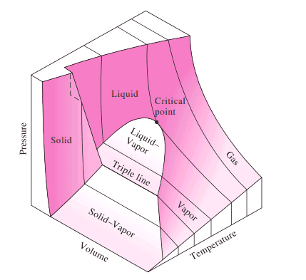

Hi Stephanus, please consider the image below
at 1000C values of enthalpy corresponds to an isotherm(temperature fixated or constant at that point, see image). You have correponsding enthalpies for gas and liquid consequently, considering the 2 phase(liquid-gas) region.
Read something on Classical Thermodynamics, you will learn a lot on this.
Likes Stephanus
