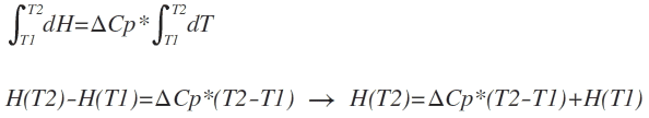

I have the following task:
The Standard enthalpy of formation of gaseous H2O at 298K is -241.82 kJ mol-1. Estimate its value at 100 °C given the following values of the molar heat capacities at constant pressure: H2O (g): 33.58 JK-1mol-1, H2 (g): 28.84 JK-1mol-1, O2 (g): 29.37 JK-1mol-1. Assume that the heat capacities are independent of temperature.
The only formula I can think of is this one:
But I don't know how to calculate this exactly. Can some help me getting started?
First, you must devise a pathway to get from reactants at 100C, through the reaction at 25C, and finally to the product at 100C.
Ok, thx
is it correct that the standard enthalpie of H2 and O2 are 0 because of the definition?
Does this mean I that I can use my formula in this way?
krootox217 said:
Ok, thx
All correct.
Likes krootox217
Therefore the ΔH(T1) is -241.82 kJ mol-1, the Cp(H2O) is 33.58 JK-1mol-1, the Cp(H2) is 28.84 JK-1mol-1, the Cp(O2) is 29.37 JK-1mol-1 and I just need to insert these values in the equation above and I get the result for ΔH at 373K and therefore my final result?
Check all your units for consistency.
I think everything is fine, I just need to transform ΔH(T1) from -241.82 kJ mol-1 to -241'820 Jmol-1 and then it should be consistent, I think
Go for it! (Note: If you had left it as kJ, you'd have gotten a much different answer. Experience will tell you that heats of reaction don't change drastically with moderate temperature change, like here, so a "wild" answer is a tipoff that something's wrong.)
Likes krootox217
Thanks a lot!
