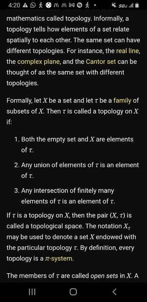

Edit: A simple search would do:
WWGD said:
This is a basic property of elements of the topology. They are closed under( finite) intersection.
Your logic is back to front. You are given a definition of a collection of "open" sets. You have to check that every finite intersection of sets in the collection is in the collection. You cannot assume that. That involves checking that the empty set in the collection.
If you assume that ##\tau## is a topology, then you can assume that ##\emptyset \in \tau## and it makes no sense to prove this using the other assumed properties of the topology.
You made the same mistake I made that @Orodruin pointed out.

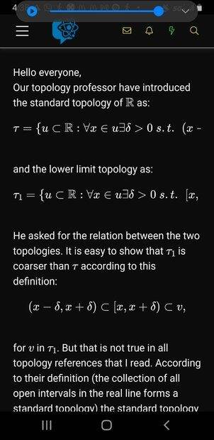

The initial post does explicitly state these are the open sets in the topology. We are _ not_ being asked to verify these define a topology, but _ we are told_ these are topologies.
" He asked for the relationship between these _Topologies_"
