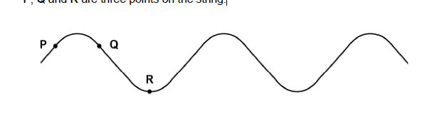

The diagram shows a stationary wave on a string at one instant in time. box
P, Q and R are three points on the string.
none that I think are needed...
I think I understand that points P and R are pi radians out of phase - reaching their max/min at the same time.
But are P and Q in anti phase?
What is antiphase exactly - is it when they are 180deg out of phase - or is it when they are anything other than totally in phase? I seem to find conflicting answers

View attachment 320750I think I understand that points P and R are pi radians out of phase - reaching their max/min at the same time.
Agreed.
Watch the animation carefully:
https://www.cyberphysics.co.uk/graphics/animations/standing-wave.gif
Antiphase is a phase difference which is an exact odd-integer multiple of π (180º), i.e. π rad, 3π rad, 5π rad, etc.
Edit. The term 'out of phase' is often used to mean any phase difference different to 'in phase'. It is not the same as 'anti phase'.
So do you now think P and Q are in phase, antiphase, or neither?

My eyes aren't what they used to be but I think the phase difference between P and R isn't 180 degrees. I see R is at the "bottom" of the wave whereas P isn't at the "top"
Remember that the question is about a stationary (standing) wave, not a progressive wave. Watching the animation in Post #2 should clarify the issue.
Edit: P and R are 180º out of phase, but with different amplitudes.

no I think P and Q are in phase (both reaching their max at the same time - thanks for the explanation - very helpful
