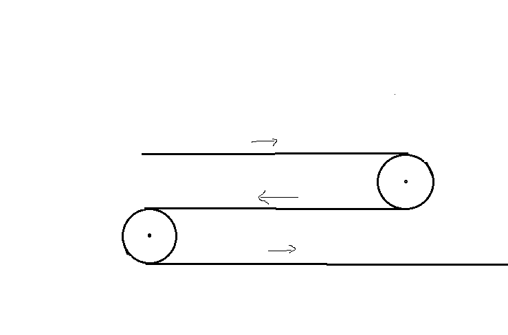

Hello,
I have the configuration as shown in attached picture. I know how to calculate string tension and measure frequency if the string is not moving. But what happens if the string is moving at a constant speed? Are there still standing waves? Can we still calculate the string tension? What if the speed of a string is slow in comparison to frequency of standing waves?
Thanks!

First, this may belong in a HW section and need to follow the HW guidance requirements.
Second, consider why and how would the equations change if a string is moving?

I was thinking that waves moving in one direction are "sped up" because of the moving string and waves traveling in the opposite direction are "slowed down". Would we actually see 2 different frequencies or am I completely wrong?
The speed of the wave in respect to the medium (string) is not changed by the motion of the string.
I understand that. I was talking from the point of view of an outside observer.
That point of view is irrelevant for the frequency of the standing waves.
