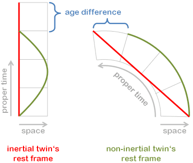

Can the clock effect/twin paradox be displayed on this diagram? Or a uniformly accelerated observer?
Or is it restricted to inertial observers?
I think for a uniformly accelerated observer it would look cone-like, as shown here for a local observer hovering in a gravitational field:
http://demoweb.physics.ucla.edu/content/10-curved-spacetime
Also use gravity slider here:
http://www.adamtoons.de/physics/relativity.swf
Here the non-local picture for a radial line through the Schwarzshild-geometry (which is non-inertial).
http://www.adamtoons.de/physics/gravitation.swf
I guess you can transform any space-coordinate diagram into a space-propetime diagram. Here for the twins:
http://www.adamtoons.de/physics/twins.swf
For the twins with constant acceleration it should look somewhat like this:
The key is that the length of all worllines (in space-propertime) represents the passed coordiante time, so they all have equal length. This is the geometrical interpretation closest to the "all moves at c through space-time" meme, that I know of.
For a non-inertial observer in such a diagram, why would you not construct it so the 'defining observer' world line is vertical??!
It cannot be good for coincident events to be separated on diagram (this occurs even for the inertial frame twin scenario) ...

His world line is shown curved, because he is non-inertial.
Yes, that's something space-coordinate time diagrams show more directly.
