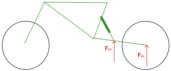

Hello,
I am building a bicycle with suspension on it. The rear wheel is connected to the bike via an axle on a swing arm (a long lever), connected to a linkage lever which is connected to a shock, which has a spring on it. Ultimately I'm trying to calculate the force applied to the shock under certain cases.
Generally, I think I understand how to calculate the force on the shock given some force at the axle on the end of the swing arm. I use the total torque and force equations and N forces.
What I'm not sure I understand is the vertical upward force (Newtons) applied to the axle when the bike is sitting at rest and when it is dropped from some height, which is probably funny cause it's much easier to calculate than the forces through the swingarm and linkage.

I want the vertical force being applied up on the end of the swingarm lever at the axle, Fav, so that I can calculate the vertical force up on the bottom of the shock at Fsv.
If the unsprung weight of the bike (my picture below doesn't show a rider but we can pretend he's there and part of the 100kg total weight) shown in green weighs 100kg, just sitting there on the ground I think Fav is 100 * 9.8 = 980N.
Now if the bike is just starting to touch the ground after falling 1m, wouldn't I additionally add the force from the acceleration of the fall? In that case I'd be adding mgh which is 100 * 9.8 * 1 = 980N (N after converting the KE to Force). Now I have an Fav of 980N from the bike at rest + another 980N due to the fall.
So, Fav at the point of impact, to be applied as vertical up force on the axel to calculate the force on Fsv is 1960N.
Am I wrong? Is it not 1960N?

In the model, let's say the shock has 3" of travel, so the spring is going to be compressed 3 inches. I want to know the spring rate the spring needs to have, in this example, let's say to compress that spring 3 inches after the 100kg bike falls 1m.
Spring Rate = Load / Travel.
Spring Rate = Fsv/3.
I know the angles and force fulcrum distances on the swing arm but in order to get Fsv I'll need to know Fav.
So I'm not sure how to get Fav so I can calculate Fsv.
My method above is how I've tried to get Fav, thinking I am looking for the force at that moment in time where a force at all begins to be applied to the axle. Sum of torque and force equations should tell me how much that force is after being leveraged through the swing arm to a greater force at Fsv. Then that force, Fsv, is applied to the spring and, with the right spring, compresses it 3 inches.
If I'm wrong, can you help me understand what number I should be using for Fav in this calculation and how I would go about getting it?

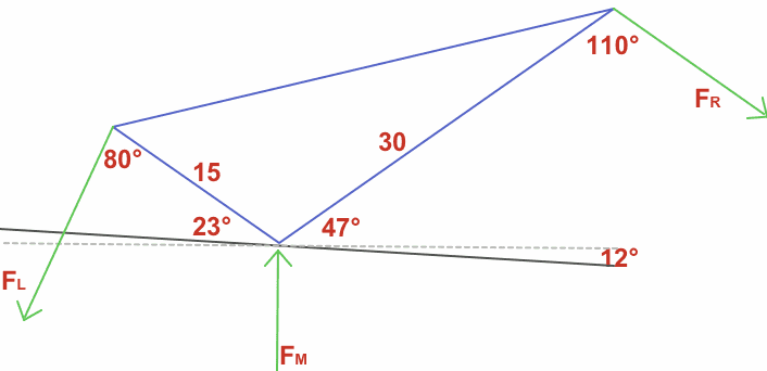

Guys, I already know all the angles in the linkage. Yes, Rx7man, there are many possibilities of angles on the swing arm, ratios to pivot point, etc. But I know how to calculate all of that for any of those given scenarios using sums of torque, forces and trig. Given some value of Fav, I can tell you what the spring rate should be so the spring is compressed 3 inches by that force.
In the picture above, which is simpler than my real world case, for sake of argument, it would be something like
Ex: 3000N (Fav) vertical up applied to axel yields 12000N to bottom of shock (parallel to it's angle). 12000/3 = 4000. Then I convert to lbf and end up with some spring rate of 600lbf/in. These numbers are complete BS but you can see the relative increase or decrease in forces.
So, how do I find Fav in order to start my trig equations in the swing arm?
If the 100kg bike is sitting still on the ground, Fav is mg right?
And if it just free fell 1m, Fav is mg + mgh?
Or haruspex, are you saying rather than Fav after a 1m free fall being mg + mgh, it needs to also consider the movement the bike will go through in the suspension? That seems strange in this case since it's ultimately the spring rate I'm trying to find and without knowing a spring rate, I can't really say how far the KE of the fall will move through the suspension.
Note: Fav is not just KE from a fall. It is the N force being applied to the end of the swing arm in a given case, even if the bike is sitting still on the ground. I want to be sure I'm applying the fall case KE correctly.

The resistance from the damper is small relative to that of the spring. Same with tires. In a 1m fall, the tires aren't going to give more than 1 or 2mm whereas the spring is going to give 76mm. So, I feel I can safely ignore the affects of the tires and damper to get a calculation close enough to get a spring to start with. Then if it's too soft I'll increase it but I'll be in range so I can obtain a spring that works.
Let me try another approach here which is quite simpler.
Let's say I just want to know how much Fav needs to be in order to compress the spring 25%. 25% is the sag I want, which means it is reached while the rider is sitting on the bike, not moving, on the ground. Now if the rider and bike weight on the rear wheel are 100kg, is Fav 980N? (We're ignoring the front wheel) Or does Fav still have to consider the .25 * 76mm = 19mm sag compression distance in the spring?
If I modeled this in the real world I could measure 100kg at the rear wheel on a scale. An upward force must oppose that weight and that upward force would then be 980N so seems Fav is 980N.
Ok.
As I hinted, the relationship between the compression force on the spring and Fav depends on the geometry. As the spring compresses, the geometry changes a little. So let θ be the angle the rear wheel arm makes to the suspension rod and Φ the angle it makes to the horizontal, measured when at max compression, say,. Do you know how to takes moments about the pivot point for the rear wheel arm?
Yes.
Yes, I think I know what you mean.
So, if Fav is 980N, that is the vertical up force. Then I can calculate the force at Fav perpendicular to the swing arm and by finding torques at Fsv and Fav I can find force at Fsv. I'll consider the angle the shock has to the swing arm to get the actual force into the shock. I know how to do this and have built a spreadsheet for it. I have the angles at 0, 25%, 50%, 75% and 100% compressed. In my real world case there are multiple calculations because there is another multiplier lever between the swing arm at Fsv and the bottom of the shock, which I've left out of this example to simplify the conversation. I'm pretty confident I know what's going on in those calculations.
You mention "moments" around the swing arm. I can reason you mean I should calculate that force on the shock using angles at different points from fully extended to the 25% compressed, as I've done at 0, 25, 50 and 75% but in this case multiple points from 0 to 25%. Say I calculated the force on the shock at 4 different points from 0 to 25% compression, then would I simply average these to get the force to be used as the force on the shock in calculating the spring rate?
No, the "moment' of a force about an axis is the force multiplied by its perpendicular distance from that axis. At equilibrium, the moment Fav has about the pivot will be equal and opposite to the moment the force from the suspension rod has about it.
Not exactly sure what you mean, but it doesn't sound right.
Are you saying that you will measure the compression at different saddle loads, and want to calculate the spring rate from that?
Builder89 said:
I understand all these variables are there but like I said I can change the spring weight to best fit actual conditions. I'm just trying to get in the ballpark. I don't want to build so much leverage into the swingarm and linkage that a 10lb spring is required to compress the full travel or the opposite, so little leverage I end up needing a 1500lb spring. I can get a spring from 250 to 400lb easily so getting somewhere in there is good.
No, the force the damper exerts is proportional to the velocity... so if you're just standing on the bike, the damper really is a negligible force.. however, if you're falling from 1m, it will be a VERY significant force.. even more so if the fall is from 2m.. if it didn't exert a significant force you wouldn't equip the bike with one :)
Maybe I was just overthinking it there. In my inexperience, I missed what you meant by "moment".
"moment of force". Yes, I understand it and have been referring to it as torque. When I've mentioned in prior comments the sums of torques I've meant what you are referring to as moments and equilibrium. The concept that the sum of the opposing torques must equal 0 total torque and the sum of the opposing forces also equal 0.
That was the thought yes. But it was coming more from my method of calculating the spring loads for the full swing arm rotation to 100% compressed. I planned to average forces from multiple points along the rotation because the amount Fav applies to the shock changes based on the geometry of the swing arm and more so the second lever (the linkage) between the swing arm and the shock (in my actual suspension design). The second linkage lever multiplies the force to the shock. This has to happen in real life because the distance the swing arm travels at the point the shock would otherwise be attached (Fsv) isn't 3 inches. It's lucky to be 2 before the wheel hits the fender or it's moved through the equivalent vertical distance the front shock goes through. The linkage will multiply that distance at the shock to 3.5. So, the result is that the force being applied to the shock isn't linear through the rotation of the swingarm. It actually becomes less as the swing arm moves through the rotation, resulting in an increasingly stiffer response as the linkage takes more and more force to push the spring. Of course this is configurable and part of the research I am doing here.
The geometry doesn't vary greatly from 0 to 25% compression but it does a little bit. Am I correct to average the forces measured using geometry at multiple points between 0 to 25% to get a more accurate measurement of force applied? Or can I just take a snapshot in time at the point the suspension is 25% compressed and calculate the force on the shock using geometry at that point?
Just use trigonometry to find the force.
I think you're making this far more complicated than you need it to be.. I would start out with a static load, forget about falling 1m... Figure out how much "sag" you want in the suspension with a rider at standstill, Work out the angles everything is at with that load on it, find the right spring.
The job of the shock absorber is for they dynamic load.. it's not the springs job!
Assuming for simplicity that the unsprung assembly is a rigid structure then the initial impact force at the ground contact will very high; but, the contribution of the spring and unsprung weight will be limited due to the fact that there is no instant change in the velocity of the unsprung weight at the time of initial ground/wheel contact. If you want to determine the maximum load experienced by the unsprung assembly then it is necessary to calculate the KE = mgh of that structure based upon the velocity of the unsprung structure at the time of impact and then use this as the energy to be absorbed by the spring during its compression travel i.e., mgh = 1/2 k x^2, giving,
x (total) = Sqrt(2mgh/k) + x (spring preload), then F total = k x (total) is the maximum instantaneous impact force on the unsprung structure at its connection point to spring and the spring connection to the unsprung weight. Obviously any spring mounting angle from the vertical will require modification of this calculation to account for the force vectors.
All of this is already presented in different forms in the above posts but seeing it as a sequence of calculations has always made it easier for me to visualize.

OK, but I'd like to be confident you are calculating the torques correctly: ##\tau = Fr\sin(\theta)##
  • #33
I'd love for you to look over them. :-)
Here's how I calculate the vertical force up (FM) on the swing arm, which would then have the shock angle taken into account as applied to the bottom of the shock.
The free body diagram would look like this:
Let's just say FR = 100N (cause I forgot we already calculated 980N)
I find FM using the torque equilibrium about FL.
FR(cos12)(495) = FM(cos12)(102)
FR(484.14) = FM(99.7)
485.60N = FM
Then, let's say the shock is stood up 50° clockwise from horizontal with the bottom touching the point of FM.
The force into the shock, FS = cos40(458.60) = 371.99N
Look right?
  • #34
No, you have to treat FR and FS as two forces acting at different angles on the arm, balancing:
FRcos(12)(495) = FScos(40)(102)
  • #35
Hmmm, really? I feel you're wrong. FL is the pivot point, O. FM and FR are torque forces working to twist around FL in opposite directions.
