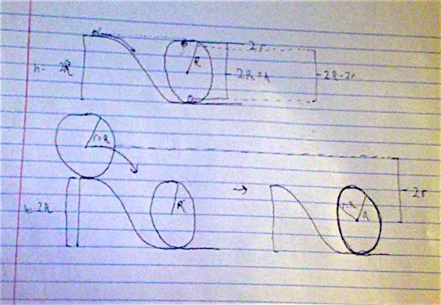

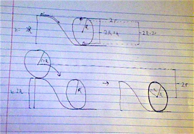

Ok, I drew this: (sorry, poor quality)
And from the top of the hill, it seems that the marble falls as far as h is, which makes sense.
So is the potential energy at the top of the hill equal to mgh, but at the top of the loop equal to 2(R-r)? That would make the equation:
h=(R-r)(1/2+1/5+2)
h=(R-r)(1/2+1/5+2)
Yes. It's the 2r drop, rather than r, that you were missing.
