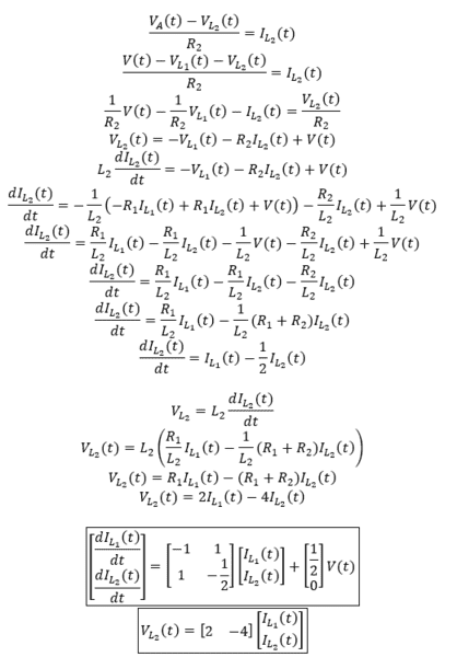

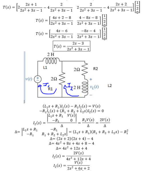

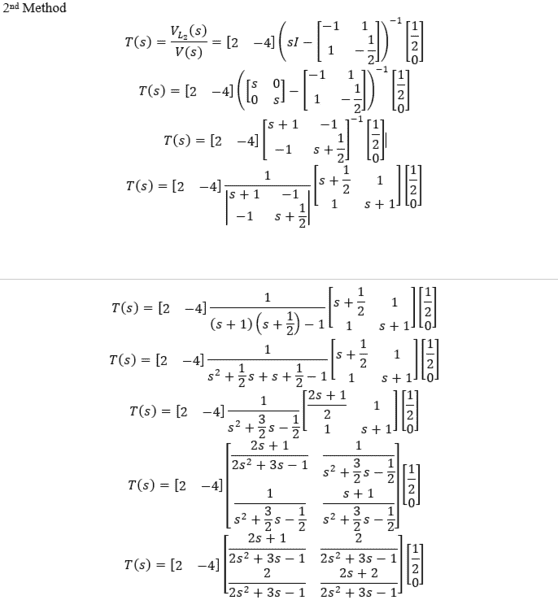

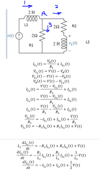

For the given circuits, identify state variables and derive a state-space model for each.
Assume the input is v(t) and the output is vL(t).
[/B]
So my issue is that I solved this problem using two different methods. First method I used was trying to find the state space model directly using KCL in the time domain. I then took my state space model used derived using this method and found the transfer function. I then found the transfer function directly using mesh analysis. For some reason I got two different transfer functions. So that means either my state space analysis from my first method was incorrect, or the second transfer function I found using mesh analysis was incorrect. I'm not exactly sure what I did was incorrect, my transfer function using mesh analysis, or my state space analysis. Any help would be greatly appreciated.

The form of your answer using the 2nd method looks correct (bandpass filter), but I didn't check the math in detail
But it seems like you dropped a V(t) term in you answer using the first time-domain method? (Or I could be missing something)...
