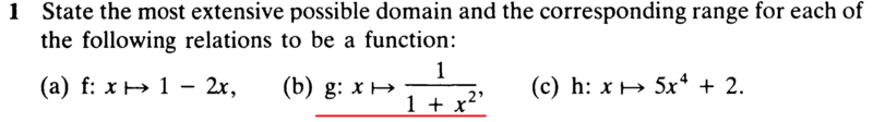

State and domain and range for the following function : ##g(x) = \dfrac{1}{1+x^2}##

Let me copy and paste the problem as it appeared in the text. Please note that the given problem appears in part (b), which I have underlined in red ink in this way ##\color{red}{\rule{50pt}{1pt}}##
Clearly the domain is ##\boxed{\mathscr{D}\{f(x)\}: x\in\mathbb{R}}\quad\color{green}{\Large{\checkmark}}##

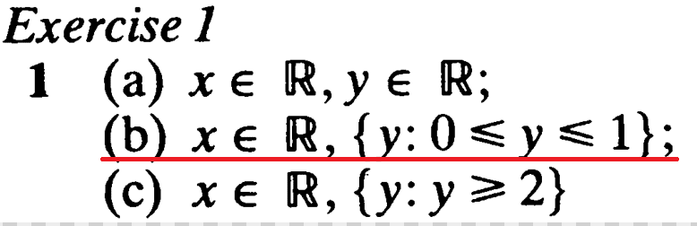

Shown is the answer in the text (part (b)).

\end{align*} Hence the range of the function ##\boxed{\mathscr{R}\{f(x)\}\in (0,1]}\quad\color{green}{\Large{\checkmark}}##. The answer in the text (shown above) is wrong to include the point ##0##, or it is me mistaken?
I agree with you.
