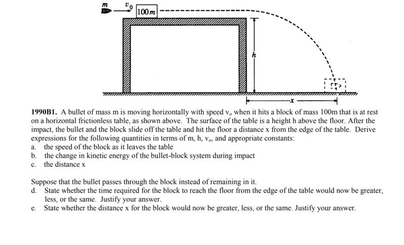

State whether the distance x for the block would be greater/less/same

Attached problem below!
Conservation of momentum and Conservation of energy
I was able to solve for a, b, c, and d.
I don't know whether I'm saying it right for part e.
The first scenario is a perfectly inelastic collision. After impact, the bullet transfers momentum to the block, causing the block to move (it was initially at rest), and the bullet + block fall at a distance of x. However, when we perform energy conservation for the block-bullet system, the final velocity is less than the initial velocity of the block.
The second scenario is a perfectly elastic collision. During the impact, the bullet transferred some of its momentum to the block and leaves with velocity less compared to its initial velocity but a higher velocity compared to the block, and thereby the block should have landed at a distance less than x.
Was it right?

You wrote that the block's velocity in the second scenario will be less than that of the bullet in the second scenario. To show the distance is less in the second scenario than in the first, you need to refer to something that is different between the two scenarios.

Just concentrate on the point, within each scenario, where the block is about to leave the table. What is different for the block in the second scenario from its attributes in the first?

Okay, the horizontal component of the velocity is different in both scenarios.
Right. So step back a bit further. Why is the horizontal velocity of the block different?

This is an inelastic collision. What can you be more precise about than transfer of energy?
In an inelastic collision, kinetic energy is not conserved, but momentum is.
Right. So can you use conservation of momentum to show that the block will acquire less velocity if the bullet passes through it?

Right, but you know that in the first scenario ##v_{bf}=v_{wf}## and in the second scenario ##v_{bf}>v_{wf}##. If in your equation above you increase ##v_{bf}## what happens to ##v_{wf}##?
It(##v_wf##) will decrease.
So the distance to hitting the floor will ….?
decrease too!
paulimerci said:
decrease too!
Bingo.
