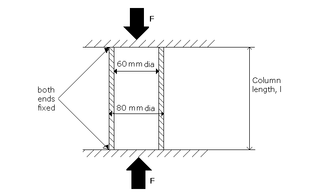

A column has the dimensions shown below...
Column material properties:
young's Modulus E = 200 GN m^-2
Yield stress = 140 MN m^-2
a) what is the minimum length of the column at which buckling is likely to occur?
i got an answer of: 2*((118.74 * Sqrt((2.33x10^3)/(2800x10^-3))) = 6850.56 M
oxon88: Your current answer is wrong. Try again. First, list relevant equations. And then show how you computed each numerical value used in your final equation.
By the way, MN*m^-2 is called MPa. And GN*m^-2 is called GPa. Always use the correct, special name for a unit. E.g., 140 MPa, not 140 MN*m^-2.
least second moment of area. I = (B^4 - b^4)/12 = (80^4 - 60^4)/12 = 2.33x10^6
area. A = B^2 - b^2 = 80^2 - 60^2 = 2800
σ = 140x10^6
E = 200x10^9
effective slenderness ratio. E.S.R = sqrt(pi^2.E/σ) = sqrt(pi^2.(200x10^9)/(140x10^6)) = 118.74
effective length. L = (E.S.R). Sqrt(I/A) = 118.74(sqrt(2.33x10^3)/(2800)) = 3427.7
effective length = 1/2 column length. = 3427 x 2 = 6854 mm
I also tried another method and got the same answer...
Least value of radius of gyration. K = (1/2).sqrt((B^2+b^2)/3) = 1/2 sqrt((80^2+60^2)/3) = 28.868
effective length. L = (E.S.R x k) = 28.868 x 118.74 = 3427.73
ok. so i worked it out.
the answer is 5.94m
ok. So if the column was to be 5.94 m. What would be the mode of failure? and at what load would you expect the failure to occur?
I guess it would be buckling?
any ideas?
useless forum...
We are not allowed to answer your homework questions for you.
Hi all, I have the same question and was getting the same answers originally. I assume that your new answer is based on changing the formula to a hollow tube. I was wondering without being told in the question how we are supposed to determine what shape it is... Or am I being a bit thick...
Wrong formula
The least second moment of area I about the xx axis is not what you stated so your value is incorrect. I get L = 5.236389088 m
