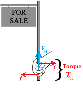

You are holding a sign as shown below. The sign (including the horizontal bar it hangs from) has a mass of 2.20 kg and is 40.5 cm wide. The sign is hanging from a 1.03 m tall, 4.46 kg vertical post. The sign is symmetric with a uniform mass distribution as implied by the drawing
What external force (+ if up, - if down) and torque (+ for CCW, - for CW) do you have to apply with your hand to keep the sign in static equilibrium? [Use g = 9.80 m/s2 and ignore the width of the vertical post.]

Your vertical force calculation looks okay, but I'm not understanding your torque equations. The vertical post itself would not require a torque to keep vertical. What are you taking as the mass and center of mass for the torque from the sign?

Note that the hand applies both a force and a torque. The torque is in the form of a "couple". The torque due to a couple is independent of the choice of location of the axis of rotation.

You did not include the torque (couple) provided by the hand.
I recommend taking the axis of rotation to be some point on the vertical rod.

When you say the torque is in the form of a couple, does this mean that there is some horizontal force acting on the vertical bar I need to solve for?
See figure below. The couple can be thought of as due to the two red forces f. You do not need to find f. You just need to find ##\tau_H##.

Turns out I just needed to use the vertical post/hand as the axis of rotation, giving me a torques equation of:
0.2025 * 2.20kg * 9.8 = Torques CW
(torque caused by the sign) = (torque provided by the hand to keep the system in static equilibrium)
... giving me an answer of -4.3659, negative since its clockwise.
Thanks TSny and berkeman.
