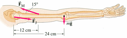

Calculate the magnitude of the force, FM, required of the "deltoid" muscle to hold up the outstretched arm shown in the figure. The total mass of the arm is 3.3 kg. Then, calculate the magnitude of the force FJ exerted by the shoulder joint on the upper arm.

X direction:
Fjcos(theta)-Fmcos15=0
Y direction: Force of weight=32.2N
-Fjsin(theta)+Fmsin15 Force of object=83.3N
-32.3N-83.3N=0
tnet=Fm(0.12m)(sin15)-32.3N(0.24m)(sin90)-83.3N(0.52m)(sin90)=0
Fm=1644N
How would you this problem change is there is no weight in the hand like the above problem suggests?
If there was no weight, you would not include the force of gravity from that weight or the torque caused by that force in your calculations.
Does this mean I just leave it out or do I alter the equation in some way?
I got part a:
tnet=mg(24m)-Fmsin15(0.12m)=0
Fmsin15(0.12m)=(3.3kg)(9.8m/s^2)(0.24m)
Fm=(3.3kg)(9.8m/s^2)(0.24m)/0.03106m
Fm=250N
How do I figure out Fj for part b?
