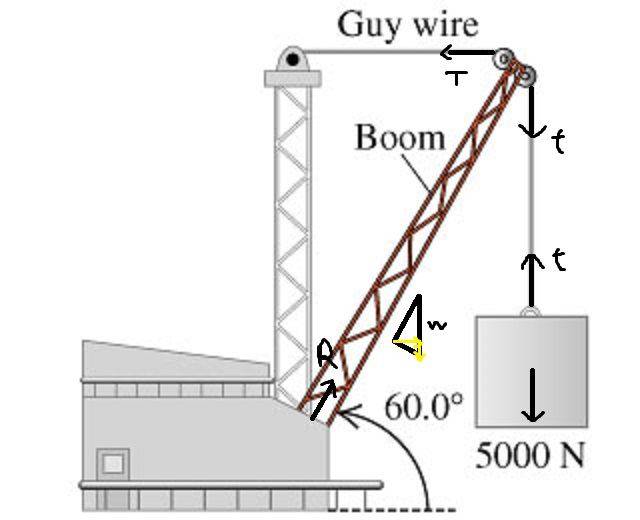

The boom in the figure below weighs 3100 N and is attached to a frictionless pivot at its lower end. It is not uniform; the distance of its center of gravity from the pivot is 35.0 % of its length.
$$\sum\vec F=\vec0\\\sim\vec\tau=\vec0$$
The diagonal component of the boom's weight is ##R=w\cos\frac{\pi}{6}=\frac{\sqrt 3}{2}w##, and, considering ##R## as a "reaction", we have ##R_x=R\cos\frac{\pi}{3}=\frac{\sqrt 3}{4}w## and ##R_y=R\sin\frac{\pi}{3}=\frac 34w##.
I will also have ##w_x=w\sin\frac{\pi}{6}\cos\frac{\pi}{6}=\frac{\sqrt 3}{4}w## and ##w_y=w\sin\frac{\pi}{6}\sin\frac{\pi}{6}=\frac 14w##.
$$\sum F_y=5000+w_y-R_y=5000+\frac 14w-\frac 34w=0\\w=10000\,N
\\\sum F_x=T-R_x-w_x=T-\frac{\sqrt3}{4}w-\frac{\sqrt 3}{4}w=0\\T=5000\sqrt3\,N$$
I messed up, probably because of ##R##. Let me consider the torques about the axis through the point of application of ##R## (in the image).
$$\sum\tau=0\Leftrightarrow lT\sin\frac{2\pi}{3}-5000l\sin\frac{5\pi}{6}-0.35\times5000l\sin\frac{5\pi}{6}=0\\T\sin\frac{2\pi}{3}-1.35\times5000\sin\frac{5\pi}{6}=0\\T=3375\,N$$
At your picture the reaction R is directed along the boom Why? A priori you do not know its direction

You seem to have used 5000N for both weights.
Wrt @wrobel 's point about the direction of R, consider moments about the top of the boom. If R acts along the boom then the weight of the boom is the only force with a torque about that axis.
I didn't really consider reaction; I tried to come up with a force in the direction of ##T## so I decomposed the boom's weight in the way shown, but that makes a diagonal force that needs to be cancelled, hence me supposing ##R##.
The wrong step I did in summing up the forces was decomposing ##R## without decomposing its weight counterpart.
I need a vertical force to find the boom's weight, but I still don't see where it is.
Hm, right. I can also find ##R_\perp=-\frac{13}{40l}w##. Don't see how that helps me, though.

The weight of the boom is given, 3100 N. And the force from the pivot does not act along the length of the boom: it has both vertical and horizontal components. No use to count with it. Solve the problem with the torque method.
I forgot about it being given... Thank you.
$$\sum\tau=0\Leftrightarrow lT\sin\frac{\pi}{3}-5000l\sin\frac{\pi}{6}-0.35\times3100l\sin\frac{\pi}{6}=0\\T\sin\frac{\pi}{3}-6085\sin\frac{\pi}{6}=0\\T=\frac{6085}{\sqrt 3}\approx351.\times10^1\,N$$
I think this is good. Afraid of checking on the platform, though o_O . Anyone can confirm?

Correct, but why do you give it in 10 Newtons, instead of Newtons, , with two significant digits?
Thank you. It is in three significant figures, since I'm taking ##35.0\%## as having that number of SFs.
You are right! But even then, you can write it out as 3510 N , or 3.51x103 N
