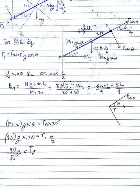

Equations: Net torque=0=Net force
I believe this is a static equilibrium question but can't figure out how to do it
ah got it thank youDelta² said:You get involved with the forces along the line of the 80Kg rod, that's not what you should do, the x-axis is not the line of the 80Kg rod, the first picture at OP shows which are the x -axis and the y-axis.
In the y-axis you got the weights of the rod and the mass m, 80Kg and 10Kg respectively (and the F_y component of the force from wall at A).
In the x-axis you got F_x and the tension T from the cable.
