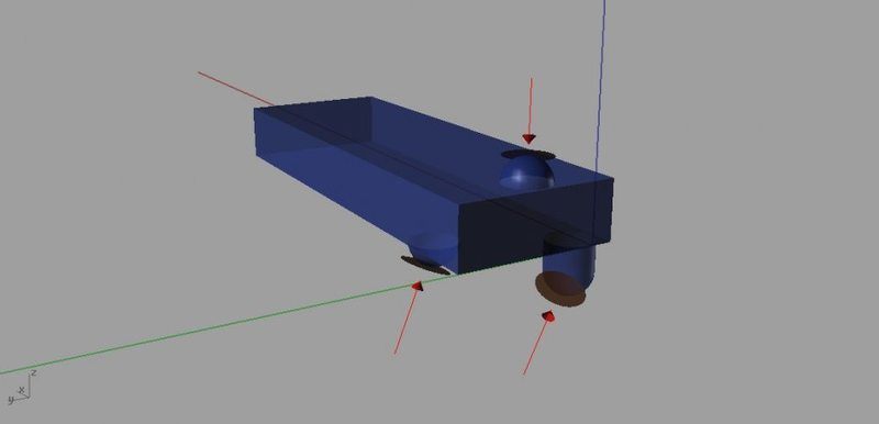

This is a real world application. I am posting it here to follow the guideline for any "coursework-like" questions, but since I have no formal training, I'm not sure what category this would actually fall under. Any recommendations for a more specific posting location would be welcome!
I have a cantilever beam in static equilibrium, with a known mass and center of gravity. It is supported at one end by contact at three points inside an irregularly shaped cavity in a wall. My task is to find the force(s) present at each of the points of contact, which have known coordinates and a known normal direction. For better visibility, the image below only shows the three relevant surfaces (brown disks) of the cavity, where they contact spherical protrusions on the beam.
If friction at the points of contact is zero, then I can easily solve for the unknown forces (red arrows) at the points of contact by using translation and/or moment equilibrium equations, since the direction of the force at each of the points of contact must be normal to the contact surface, and I therefore only have three unknowns (the magnitudes of the forces).
However, in the actual scenario, friction IS present between the beam and the cavity at the points of contact, and here I run into trouble. I am conceptualizing the frictional forces as a vectors originating from the contact points and tangent to the contact surfaces, but since they could also point in any direction on the contact surface, I now have nine unknowns and only six equations of equilibrium from which to find them.
What am I missing here? It seems like the system must have a unique solution.

This system does not have a unique solution anyway . The only way to deal with a system like this is to base all calculations on the worst case configurations of loading and fixation .
You can use professional judgement about what are the worst case configurations or you can analyse multiple cases and rank the solutions .
In the idealised world of rigid bodies, arrangements with multiple frictional forces do not necessarily have unique solutions. A simple example is an object rammed into V cleft. In the real world, it depends on the elastic properties of the materials and how the arrangement was produced.
I agree with your counts of unknowns and statics equations. To get more equations you could throw in, say, that the normal forces are to be minimised.

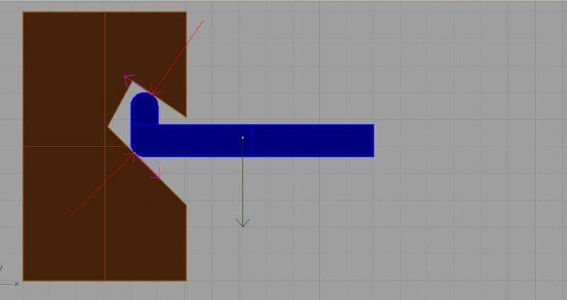

After thinking about this some more, I don't think that considering deformation is necessary. The beam would not be wedged tightly into the opening. The more natural entry method would be to simply insert the beam at an upwards angle, then let gravity bring all the points into contact. Here is what I think is the 2-dimensional analogy:
In the 2-D version there are only four unknowns (the magnitude of the two normal forces, and the magnitude of the two tangent forces due to friction), so it should be simple to find a rigid body solution. Of course in the real world the beam would deform somewhat even if it was lightly placed rather than rammed into the opening, but I still believe a rigid body solution would be an accurate enough representation to serve my purposes.

Good idea to start with a simpler version: 4 unknowns but only 3 equations.
Yes, looking for a solution that minimises a force is reasonable, but it is not obvious whether it matters which force. I suspect that in this 2D example it won't matter, that all forces are minimised simultaneously. Might not be true in general.

As drawn, it would only be unstable if the coefficient of friction is too low. Assume we are to find the minimum for stability.
Oops, I was mistakenly thinking that there would be four equations of equilibrium for the 2 dimensional version. Of course, there are only three!
