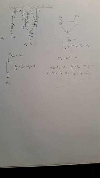

A former student of mechanics wishes to weigh himself but has access only to a scale A with capacity limited to 120 lbs and a small 20-lb spring dynamometer B. With the rig shown he discovers that when he exerts a pull on the rope so that B registers 19 lb, the scale A reads 96 lb. What is his correct weight?

ΣF=0
Take more care to only add all the forces acting on an object. If a weight is only acting through a tension, then you add only the tension not the weight too.
yes of course. ΣFy= -19-96+4TB-TA=0 thanks Dr

Unfortunately, we can't open that link from Wiley without a username/password.
