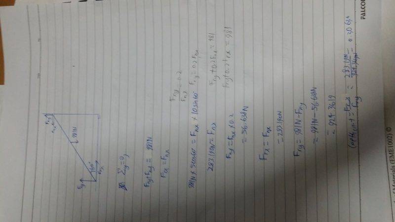

A ladder,10 m long and having a mass of 25 kg, rests on a rough horizontal floor and is supported by a rough vertical wall. The ladder is inclined at 60 degrees as shown and starts to slip when a person having a mass of 75 kg has climbed halfway up it. The coefficient of static friction at the wall is 0.2. Assume the weight of the ladder to be concentrated at its midpoint. Calculate the coefficient of static friction at the floor.
I've been stuck at this question for 3 days and I am still unable to find the coefficient of static friction at the floor. I have drawn the free body diagram and tried to solve it, getting a static friction of 0.3. Please tell me what is wrong with my workings, I don't want to ponder over such this question any longer.(sorry for my terrible handwriting)
Please explain your 4th line.
Notice that the ladders just started to slip, so: Is it ok to say that the net force on the Y axis equals zero?
Also think about this: Isn't it necessary to add a rotation equation to solve this problem?

I was trying to use the principle of moments, taking the ground contact as the point of reference

Uhm...so I can only equate Y forces as 0 when I only take the weight of the ladder into account ? So do I equate X when I take both the ladder and the person's weight into account ? Also, what do you mean by rotational equation ? Is it the principle of moments ? If it is, Then I have used it in my fourth line.
Your handwriting is essentially unreadable. Please type out your equations, and define your variables. You should have a force balance in the x direction, a force balance in the y direction, and a moment balance around some convenient center of rotation.

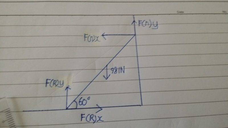

A clearer picture of my free body diagram.
Σy=0,
F(n)y+F(r)y=981 N (weight of the ladder and the person combined)
Σx=0,
F(r)x=f(n)x
Using principle of moments, take the contact between the ladder and the floor as the pivot.
981 N* 5cos(60°)m=F(n)x*10sin(60°)m [10m being the ladder's length]
F(n)x=283.190N
F(n)y=F(n)x*0.2=56.638N
F(r)x=F(n)x=283.190N
F(r)y=981N-F(n)x=924.3619N
coefficient={F(r)x}/{F(r)y}={283.19N}/{924.3619N}=0.30630
so...where have I gone wrong ?
Moment balance misses term for Fny

Thank you for your help, I've already found the answer
Thank you so much for pointing that out ! I've managed to get my answer

The moment balance is incorrect because you left out the moment from the friction force F(n)y.
