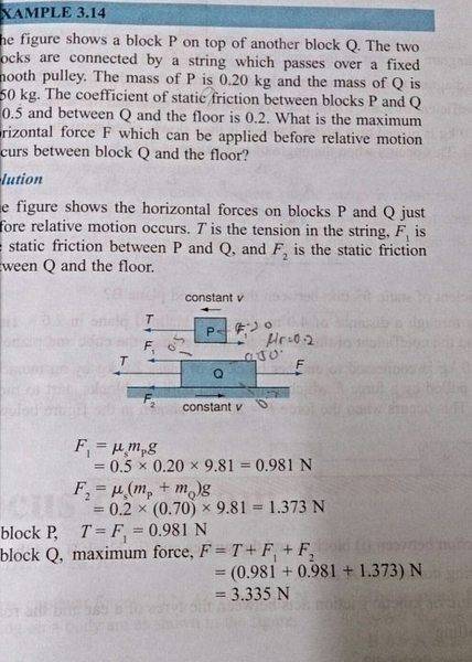

Static friction between 2 blocks and tension of string
In summary: If block Q moves to the right, block P will move to the right, and the tension on Q will be the same as the tension on P.
goldfish9776
310
the maximum force is F=F1 +F2 + T as shown in the textbook...
I can't understand why the tension of spring is also = F1...Is it because of the writer assume the spring is directly attached to the part P (upper part of the block) ??
It says string, not spring.
Consider the horizontal forces on block P. Given equilibrium, what equation can you write?
F= umg

That's only one of the two horizontal forces acting on P. What's the other one?
The other one is static friction force
How about q ? There's only static friction force? No tension of string acted on q ?

I'm trying to lead you to the answer to your question. Stick with P. There are two horizontal forces on P. Look at the diagram. What are they?
No, ##F=\mu mg## is the static frictional force. What is the other horizontal force on P?
Tension of string
goldfish9776 said:
Tension of string
Right. If there's static equilibrium, what does that tell you about those two forces?

How do the two forces on P (static friction and tension of string) compare when the objects are stationary?

static friction = tension of string when the object is stationary
Right. Does that answer your question in the OP?

You asked why the tension is equal to the frictional force. That is now explained.
What do you mean by the tension of the string "not existing" for Q? Do you mean it does not act on Q? Clearly it does. What makes you think it does not?

As os clear from the diagram, the horizontal forces acting on Q are af1 (but this is opposite to the F1 acting on P), F2, and T.
From the earlier analysis of block P, T is equal and opposite to the F1 acting on P, and therefore completely equal to the F1 acting on Q.

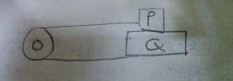

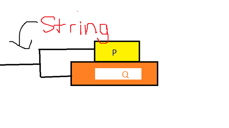

Can someone draw me a diagram so that i can understand better . Since the question say both blocks are connected by a string . So , i assume the blocks are connected in this way...Correct me if I'm wrong...

That's wrong. Read the question again. It's just one piece of string that goes off to the left from P, around a pulley with a fixed axis, and doubles back to connect to Q. That's why the tension is the same.

Something like this?
If this is true , then which part of rope should I pull ? the upper part connected to the block P or the lower part connected to the part Q ? How can be the tension be the same ?
If I pull the upper part , then I agree the tension of the rope should be = F1
If I pull the lower part of the rope , then I think that the tension of the rope should be = F2
Neither part of that string is being pulled directly. Q is being pulled to the right by force F.
If the tensions in the upper and lower parts of the string are not the same then there will be a net torque on the pulley, making it turn.
Consider the forces on each block separately.
Write down the static equilibrium equation for the horizontal forces on P, then do the same for Q.

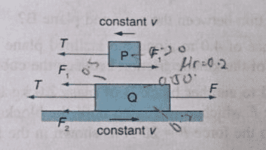

Compare the above with the figure from your book:
The vectors labeled T and T correspond to the pull of the string on each block. This is the string you have which passes over the pulley.
The vector labeled F, going to the right from block Q, represents some external force. This is the force necessary to move Q at a constant velocity, v. The portion of the problem we can see does not state how this force is applied to Q; whether by some string or by other means.
In your figure, block Q is being pulled to the right by some force which you have not included.

I'm fishing around trying to understand what wrong idea is blocking you on this. Maybe the clue is in the above two statements.
"You" do not pull on either of those parts of the string. "You" supply the force F going off to the right.
Without friction, block P would move to the left and block Q would move to the right. On block Q, T and F2 act in the same direction, so they add.
Your notion that the tension would somehow match F2 could only be right if Q were tending to slide left, making T and F2 oppose (and if P and F were not present).
