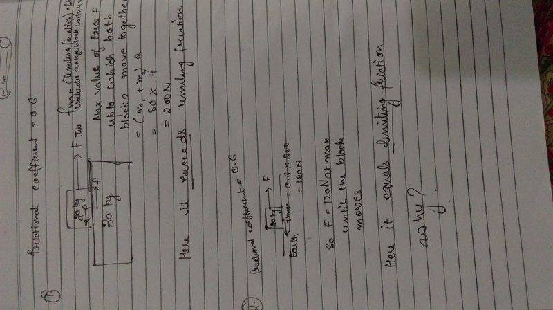

Doubt - Force cannlt exceed limiting friction for a block to remain at rest on ground.
However for to blocks to move together, it becomes more than limiting friction, yet only static friction is acting on the blocks? Which moves the lower block. How can it be more in this case? Relative motion is zero in both cases.
I am missing some crucial point here but I am unable to find the flaw.
A direct answer or hint whatever is given would be much appreciated.
Image of the problem is attached. It's not a homework problem, it's a solved example alongside another situation I created to show what doubt I am facing.
Just in case it isn't clear in first case lim. Friction is 120 N

Which force? If the blocks accelerate together, the static friction between them is different from the force applied to the upper block.
The force being applied on block.
No, as the quote you found states : "...the maximum value for static friction (that is μ*N) applies only to the friction force..."

Only if the object isn't accelerating.

Because the friction force doesn't exceed μ*N.

Niklaus15 said:
So as far as I understand, static friction will act so long as relative motion is zero, doesn't matter the situation - on ground or between blocks. Max value of static value starts acting when the applied force exceeds limiting friction. Then if the magnitude of applied force increases, friction stays at its max value so long as relative motion is zero.
Well, if the applied force exceeds the force from static friction the object begins to accelerate. You cannot exceed the force of static friction and still have zero motion.

To say what will happen from a static state, as you increase the applied force, you have to know both coefficients of friction: between blocks, between bottom block and ground.
