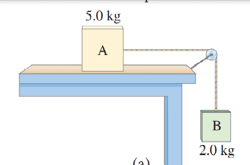

For the system of Fig. 4–32 (see below), how large
a mass would box A have to have to prevent any motion
from occurring? Assume the coefficient of the static friction = 0.30.
Newton's Third Law, Newton's Second Law.
Ok, logically, it must be that the static friction force of block A equal to the force of gravity on block B, so mass of block A is:
m_A * 9.8 * 0.30 = m_B * 9.8
m_A * 2.94 = 2 * 9.8
m_A * 2.94 = 19.6
m_A \approx 6.7 kg.
However, when I look at block A individually, there is one thing confuses me.
Say block A's mass is x, then in the frictionless scenario, tension force on block A is:
\frac 19.6 {x + 2} * x
I wonder how about if the static friction of block A is equal to the tension force on block A, because then block A should be stopped. Then:
9.8 * x * 0.3 = \frac 19.6 {x + 2} * x
9.8 * 0.3 = \frac 19.6 {x + 2}
2.94 = \frac 19.6 {x + 2}
x \approx 4.7 kg.
According to Newton's second law, then block A cannot move, because the force of tension and the force of static friction cancel out, thus, block B cannot move. So what is wrong about this thinking?
This is why it is confusing. I can understand how all of this work at the bird's eye view, but when I get to the individual level, it starts to confuse. I know my question is kind of silly, but please clarify for me.
Thank you for your help.

You know that block B is at rest. For that to happen the net force on it must be zero, which means that the tension ##T## is equal to the weight of B, ##T=m_B~g##. That is a given no matter what the mass ##x## of block A is.
Now block A is also at rest. For that to happen, the net force on it must also be zero. You already know from above that tension ##T=m_B~g## to the right acts on it. How much static friction and in what direction is acting on block A? Start from there. Then think about it this way.
With hanging mass of 2.0 kg, if block A had the mass of a battleship, would it slide? Answer: No.
With hanging mass of 2.0 kg, if block A had the mass of a feather, would it slide? Answer: Yes.
So somewhere between a battleship and a feather is a threshold mass for A such that it is not sliding but if it is decreased it by a teeny tiny little bit, it will slide. You are asked to find that threshold value for the mass of A.
The above equation is wrong.
The left side of the equation, “9.8 * x * 0. 3”, is the limiting static frictional force. It is the (maximum) magnitude of the frictional force on block A when A is just on the point of slipping but still has zero acceleration.
The right side of the equation is the tension in the absence of any friction, when the system has maximum acceleration.
There is no justification for equating the two quantities, they apply to very different situations. In fact the left side is always bigger than the right side.

Yes, but that is because, without friction, the acceleration is ##\frac {m_B }{m_A+m_B}g##.
More generally, ##a=\frac {m_B-\mu_km_A }{m_A+m_B}g## and ##T=\frac{m_Am_B}{m_A+m_B}g(1+\mu_k)##.
So as ##\mu_k## increases the acceleration decreases and the tension increases. The acceleration does not reduce to zero until ##\mu_k=\frac{m_B}{m_A}##, making the tension ##m_Bg##.
Of course, the question concerns static friction and kinetic is often a bit less.
Btw, you can make the arithmetic easier by cancelling the 'g's. There are many advantages in working entirely algebraically, deferring plugging in numbers until the end. Spotting cancellations is one of them.

I know use of symbols is generally preferred, but here’s a numerical example which might help to explain what I mean. Sorry it’s a bit long.
Let’s suppose:
##g = 10m/s^2## and ##\mu_s = 0.4## (I’ve chosen convenient values to make the arithmetic simpler).
A consists of a stack of 10 metal discs, each with a mass of 1kg (weight of a disc = 10N).
B’s mass is 2kg (weight = 20N).
When the system is in equilibrium (not accelerating), the string’s tension equals the weight of B, i.e. T = 20N.
The limiting static frictional force is ##\mu_s m_Ag = 0.4 \times10 \times 10 = 40##N. That means a tension of more than 40N is required to make A slip. So A does not slip; the frictional force acting on A simply equals the tension, 20N.
Now we reduce the weight of A by removing a disc. The limiting static frictional force is now ##\mu_s m_A g = 0.4 \times 9 \times10 = 36##N. That means a tension of more than 36N is required to make A slip. So A still does not slip; the frictional force acting on A is still 20N.
We keep reducing A’s weight by removing discs. Eventually we reach the point where A’s mass is such that the limiting frictional force (##\mu_s m_Ag##) equals the tension (20N). That means ##0.4 m_A g = 20##, so ##m_A= 5##kg. When there are only 5 discs left, A is on the verge of slipping - but the tension is still 20N.
Now we remove another disc. The limiting static frictional force is ##\mu m_Ag = 0.4 \times 4 \times 10 = 16##N.
For an instant (but only an instant) the tension (20N) is greater than the limiting frictional force (16N) and the masses accelerate. This is a ‘discontinuity’, where the system changes from being in equilibrium to accelerating. Consider what happens next.
A’s mass is now 4kg. The system accelerates. The acceleration depends on (amongst other things) the kinetic frictional force. But for simplicity and illustration purposes, let’s assume kinetic friction is negligible.
If we imagine the string ‘straightened out’, we see the system is equivalent to a total mass of (4kg + 2kg) accelerated by B’s weight (20N). The acceleration is ##a(= \frac Fm)= \frac {20}6 ≈ 3.33 m/s^2##
Considering A, the new tension (T’) is the accelerating force acting on A, so T’ (= ma) = ##4 \times 3.33## ≈ 13.3N.
The tension when accelerating (13.3N) is less than the tension when stationary (20N).
A more accurate calculation, taking kinetic friction into count, would give the tension when accelerating closer to (but still less than) 20N.

Larger that what? You got it backwards. As long as the block doesn't slide, the static friction does not have a fixed value; it is equal to the tension. It is zero if you hang no mass, 9.8 N if you hang a 1-kg mass, 19.6 N if you hand a 2-kg mass, 196 N if you hang a 20-kg mass, etc. If you increase the hanging mass, static friction will also increase to match the tension. However, it cannot increase indefinitely. There will be a point at which sliding occurs. You need a separate equation that gives the upper limit of static friction beyond which it can no longer increase. What is that equation?

Right, and if the tension is greater than that, the block will slide; if it less than that, the block will not slide. In other words, the condition for NOT sliding is ##T\leq \mu_s ~ m_A~g.##
