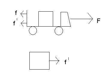

Here's a more lucid example. Consider a box in a pickup truck which is accelerating in the +x-direction. There is a net force in the +x-direction, and friction between the road and the truck and the box and the truck acting in the -x-direction. The only force on the box is due to friction between the box and the truck. The attached cartoon shows it pictorially.
Since the box and the truck are both accelerating there must be a net force on the box in the x-direction. Since the only force acting on the box is friction due to the truck, this frictional force must do work. From energy considerations, the box has a change in KE, so work must be done on the box. The net displacement of both the box and the truck is wrt to the ground.
I can't argue the point that there is work done on the box. I also can't argue that the only force on the box is due to friction. I can't agree that by their definition, this is static friction. The force due to static friction is the force between two objects in contact which must be exceeded before a displacement (slippage) occurs.
I don't understand how this definition can be valid when looking at the displacement wrt an object not causing the static frictional force.
So how to rectify the fact that the box has work done on it and the only force acting on it is due to the truck? I contend it can't be counted as static friction, but I can't come up with a solid justification for it.
Static friction is any static friction, not just the theoretical maximum static friction. HERE is a graphical representation.
Not sure I understand. Why does it matter where the force comes from? A free body diagram shows nothing but the force at the point where it touches the object. It simplly doesn't matter if (in my example) you are pushing the box with your finger or with a stick. Its not part of the calculations.
Sorry, but there is only way to reconcile the discrepancy...
If the block and paper are moving together at a constant velocity, they both have zero net force acting on them. There is friction on the paper due to the table which acts opposite to the external force. If there wasn't friction between table and paper, the paper and hence the system would be accelerating
Yes. But that still means that the force pulling the paper is doing work on it. And that of course also means the friction force between the paper and the table is doing negative work on it. The block has no lateral forces acting on it at all.

Very true. Either way, the displacement as a result of static friction wrt the two surfaces in contact is zero.
In the truck example I posted above, we are looking at the work done by the force of friction on the box due to the truck. I don't think it should be called "static friction" considering we are looking at a force which acts over zero distance between two objects in contact. Unfortunately, this is boiling down into an argument about semantics. If this is a case of "static friction doing work" then a lot of physics students are being given incorrect information because many textbooks state that static friction does no work. The caveat in this example is that the point of contact between the two surfaces is accelerating. I can buy it as a frictional force, but to call it static friction seems misleading.
Which is...?
Sorry, I should've said net work.
Originally posted by xeguy
Which is...?
Accept that static friction forces can do work.
What would you call it? In any case, I'd be interested to read a physics text that says specifically that static forces can't do work.
Also, there is no way to define your frame of reference to both include the static friction force and eliminate the motion while still ending up with balanced forces. It seems to me you are describing the motion in one frame of reference and the force in a different one.
