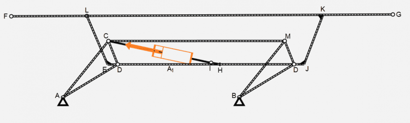

Since the system has too many unknowns for the free body diagram to be resolved, we have used tools like adams(for kinematic analysis) and abaqus(for static analysis) to solve the problem.
I have pasted the basic line diagram below, on how the system looks like. But speaking theoretically, assuming no losses due to friction. The work done by the actuator to lift the table, shouldn't it be only to lift the static load?
In the diagram, points: M,C,D,A ,B and I are pin joints. Rest are welded(means that the relative angle is fixed) Load acts on the link FG.
Would it be because the actuator is only partially under the load path?

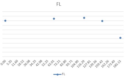

I am certain about the position I have taken to start by kinematic analysis. Moreover, I have taken 5 different positions for static analysis. The force against the position is different for both the analysis report.

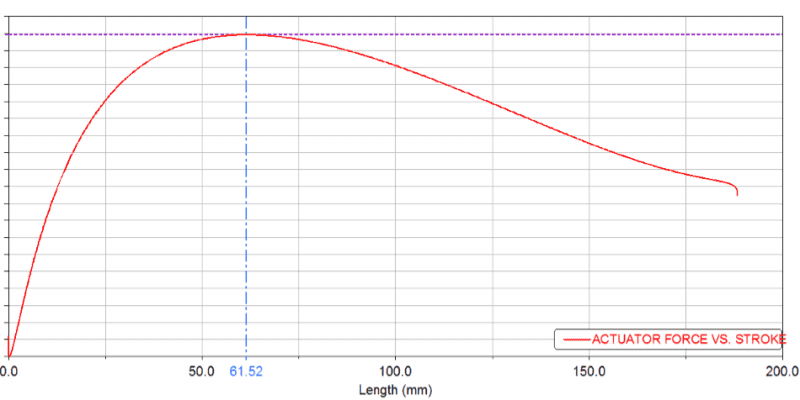

I meant try to set the acceleration 10 times lower than the value used for the above graph to see what happens, you can compare the graphs afterwards.
The graphs could use some values (I don't know what to compare with what) and I would like to know is in what position the table is when the force of the kinematic peaks so at 62 piston travel. Is it the DCH 90 deg angle situation?
Also is the end of the graph the singular position where points CDH are collinear? (you have double D in your drawing)
Btw. For nomenclatural ease we keep calling it kinematic with forces, but these two are not very compatible. Kinetics should be better, or kinematics with accelerations, just the load on the piston is nonsensical in the latter case. Anyway be sure you are not comparing accelerations in one graph with forces in the other.
The graph what you see here is plotted for a constant velocity of 4.4mm/s
The actuator is only capable of providing a constant velocity. The only acceleration component is the gravity itself.
Link CD becomes perpendicular to the horizontal plane, static analysis shows maximum force at this position, however kinetics show peak value at a different position.
(My bad in naming the nodes incorrectly. )

I ran the kinematic analysis again, this time without using the gravity and the effect of load on the table is converted to the force(which is the exact scenario as taken for FEA). And I found the actuator vs force. The curve pattern remains the same, only the magnitude drops.
