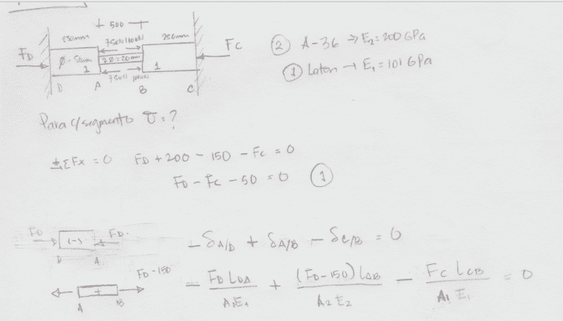

Calculate the stress in every segment of the system. AD and BC are laton and AB is steel.
geometry compatibility-δ(A/D) +δ(A/B) - δ(C/B) = 0
F(D) - F(C) - 50 =0
I supossed that DA and BC are in compression and AB is in tension. But I don't get the answer of the book, so I would like you help to understand what I am analyzing wrong.

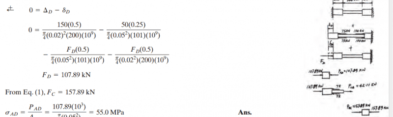

The solution is this but I don't understand it...

OK. I didn't look at what the answer key did, but I did look at what you did.
You just had some sign issues. You can't arbitrarily assume that certain members are in compression and certain others are in tension. You need to let the math do the work for you. I let the δ's represent the increases in length of the three members. If they are in compression, then the signs will come out negative. So,
$$δ_{AD}+δ_{AB}+δ_{CB}=0$$
$$-\frac{F_DL_{AD}}{E_1A_1}-\frac{(F_D-150)L_{AB}}{E_2A_2}-\frac{F_CL_{CB}}{E_1A_1}=0$$
Chet

Queren Suriano said:
But what do you write all the terms negative?Anyway if I multiplicate (-1) it turns positive; I solved assumed all terms positive and I get the correct answers, and they give possitive...So does this mean that the 3 segments are in tension?
Thanks for your help
No. The way the figure is drawn, Fc and Fd are both compressional forces. So the two end sections are in compression. What does that tell you about the center section? Also, look at how the forces are applied to the ends of the center section.
Chet
Chet
Ok, but in the center section If I substitute the force F(D) I obtain -42.11 kN. So the center section would be in compression, but in the answer is in tension...
Throughout this analysis, compressive stresses have consistently been treated as positive (see the figure). So, -42.11 kN means that the center member is in tension.
Chet
