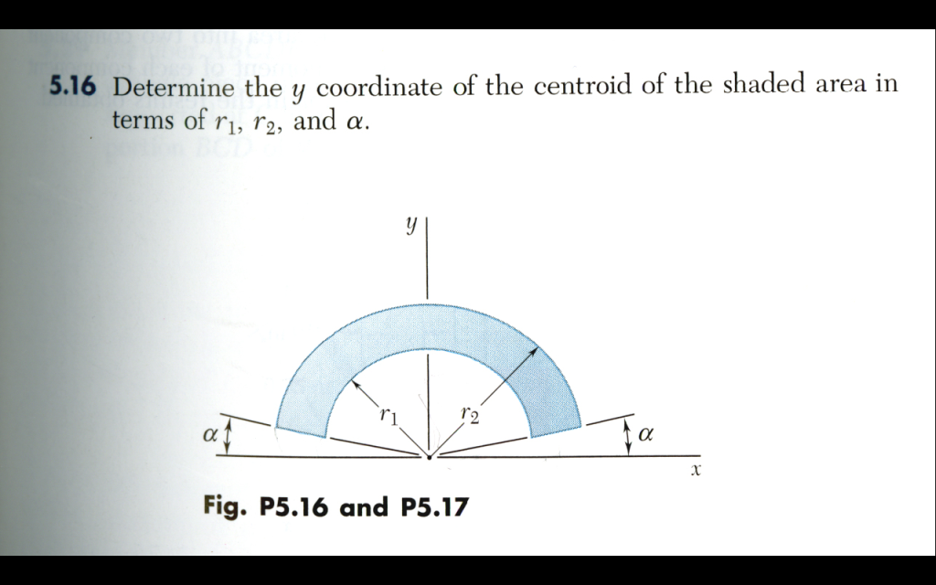

In summary, the problem involves finding the centroid of a figure consisting of a larger semi-circle, a smaller semi-circle, and two partial sectors of a circle. The formula for the centroid is X-bar = (integral of x dA)/Area, and Y-bar = (integral of y dA)/Area. The attempt at a solution involves subtracting the areas of the smaller semi-circle and the two partial sectors from the larger semi-circle to get the total area of the figure. The formulas for the area and centroid of the semi-circle are given, but the formula for the centroid of the sectors is incorrect. There is a suggestion to use the integral definition to get the centroid, and to use the double integral method. The correct answer involves
into space
Problem
Area of a semi-circle, area of a semi-sector of a circle, centroid of a semi-circle, centroid of a sector, general equation for centroid of a plate:
(X-Bar) * [tex]\Sigma[/tex]Area = [tex]\Sigma[/tex](x-bar * Area)
Attempt. I tried my best with the handwriting.
I forgot to write it down on the link above, but what I tried to do was subtract the area of the smaller semi-circle from the area of the larger-semi-circle and get an Area Q, then subtract Q by the area of the two semi-sectors.
I feel I am leaving something out with the sectors. I think it has to do with the centroids of the semi-sectors because the answer has a cosine in it and the only place where I can find a trig function is the x-coordinate for the centroid of a sector, but since the overall X-coordinate for the figure is 0, I don't know how to approach this.

The work I've shown is tabulated which is why I chose not to write it out, but I'll do my best to explain it:
What the figure is is a little less than half a donut, depending on what alpha is. Separating this partial donut into other geometric figures yields:
1 larger half-circle
1 smaller half-circle
2 partial sectors of a circle
If I subtract the Area of the larger semi-circle and the smaller semi-circle, I get a half-donut, and if I subtract it further by the Area of the 2 partial sectors of a circle, I get the Area of the figure in question (less than half a donut).

The total area of the figure is given by the subtraction of the areas of all these figures, which is:
Total A= .5*pi*(r2)^2 - .5*pi*(r1)^2 - alpha(r2)^2
where r1 is the radius of the smaller semi-circle and r2 is the radius of the larger semi-circle.
If the overall Y-bar or y-coordinate of the centroid of the figure is found by the equation:
Y-bar = sum of the y-bar centroids of each element multiplied by each individual area/total area
the y-coordinates of the elements multiplied by their respective areas are:
For the larger semi-circle: y-bar * A = (.5*pi*(r2)^2)*((4(r2))/(3*pi))
y-bar * A = (2/3) * (r2)^3
For the smaller semi-circle: y-bar * A = (.5*pi*(r1)^2)*((4(r1))/(3*pi))
y-bar * A = (2/3) * (r1)^3
Since the Areas of these figures are being subtracted from each other, their y-bar*Areas must too be subtracted:
Sum of y-coordinate Areas = (2/3)((r2)^3-(r1)^3)
The overall Y-bar coordinate of the centroid of this figure is found by dividing the sum of the y-coordinate areas by the total area of the figure, or:
Y-bar = ((2/3)((r2)^3-(r1)^3))/(.5*pi*(r2)^2 - .5*pi*(r1)^2 - alpha(r2)^2)
Which is my final answer to this question. The correct answer is:
Y-bar = ((2/3)((r2)^3 - (r1)^3)(2cos(alpha)))/(((r2)^2 - (r1)^2)(pi - 2alpha))

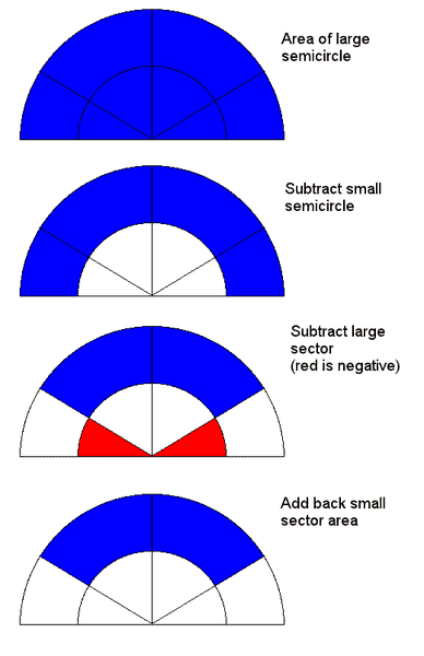

If you only do this, you are subtracting the area of the small sector twice (in the small semicircle and in the larger sector). What you need is: (big semicircle - small semicircle - 2(big sector - small sector))=(big semicircle - small semicircle -2*big sector + 2*small sector)
See this:
Huh.

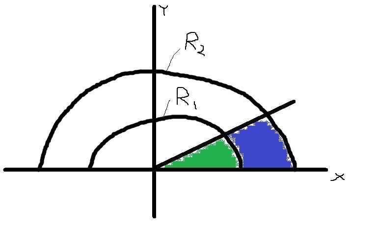

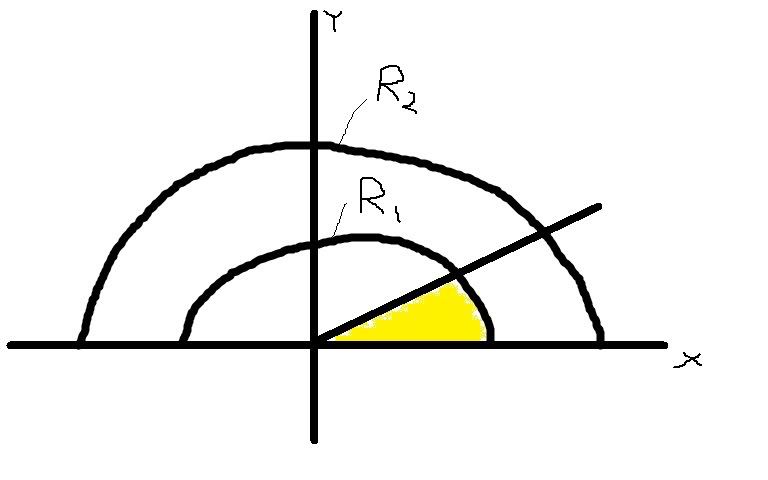

The way I'm thinking of it is like this. The area of the large sector is shaded in blue in this picture.
The area of the small sector is shaded in yellow here.
And the area of he combined sectors is overlapped in green here.
Wouldn't it be redundant to include the smaller yellow sector because it is just a scaled down version of the larger blue sector?
See the image I added to my previous post.

Makes perfect sense now. Thank you.
