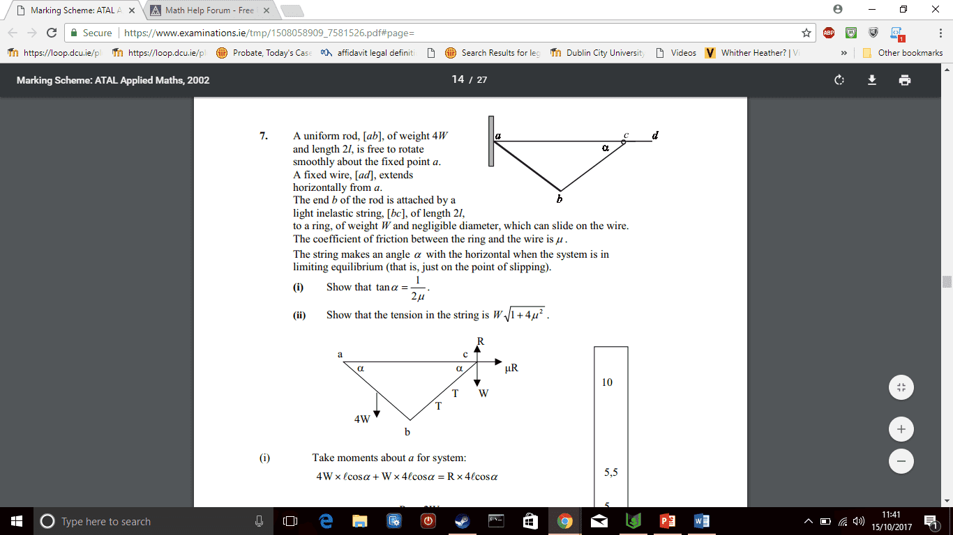

could someone please explain to me why there is no relative force at point a where the rod ab is attached to a
thanks
thanks
There is.

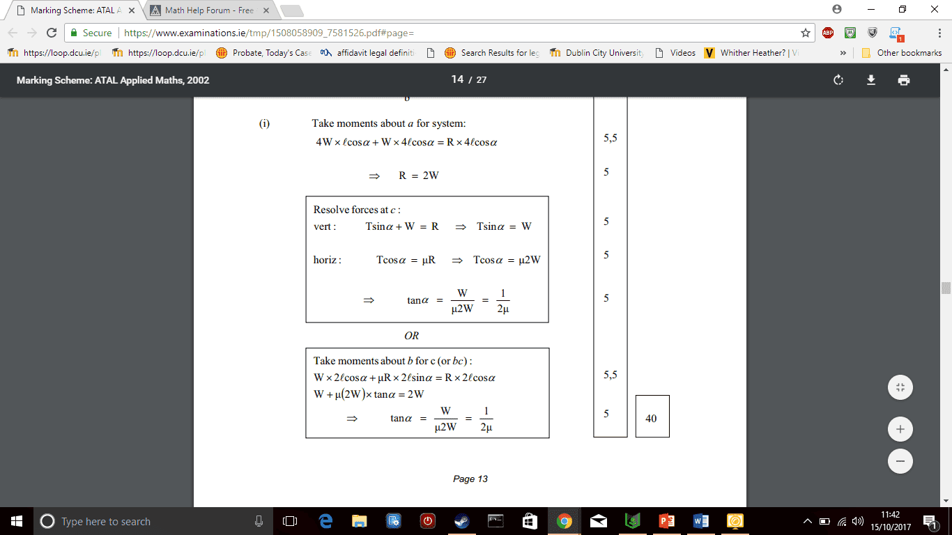

In the answer key it has been left out, since it's focusing on the moments about a.
The force at point a does not contribute to the moments about a.
thanks
I do not see how they can just resolve forces at point c horizontally and vertically. For these type of questions I was always told you can only resolve forces horizontally and vertically for the whole system not just 1 random point on the system. can you just resolve forces horizontally and vertically for 1 point on all types of questions like these.
I can also not see why/how they can take moments about point b for just point c. again I was always told when taking moments about a point you have to take all forces in the whole system about point c not just the forces at one point in the system.
