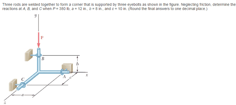

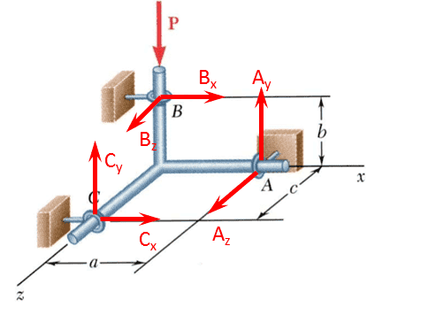

Free body diagram
Setting moment at the origin = 0
(Rb X B) + (Ra X A) + (Rc X C) = 0
solving the 3 determinants and setting the coefficients of i, j, and k to 0, I get:
8Bz - 10 Cy = 0
-12 Az + 10 Cx = 0
12 Ay - 8Bx = 0
I have too many unknowns.
summing forces :
∑Fx = Bx + Cx = 0
∑Fy = Ay + Cy - P = 0 => Ay + Cy = 380
∑Fz = Az + Bz = 0
I still have too many unknowns.Any suggestions?

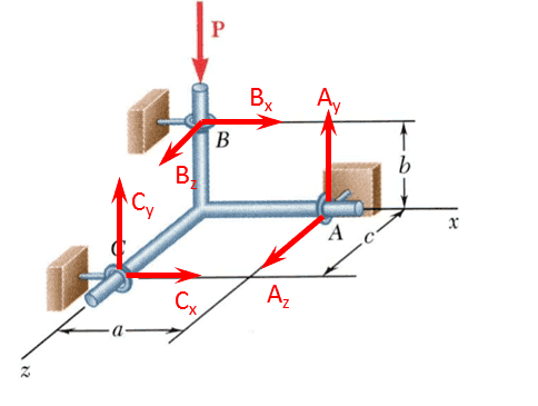

goonking said:
Free body diagram
8Bz - 10 Cy = 0
-12 Az + 10 Cx = 0
12 Ay - 8Bx = 0
summing forces :
∑Fx = Bx + Cx = 0
∑Fz = Az + Bz = 0
Just like you would do when solving a 2-D problem, it is better to write a moment equation using one of the three rings as the reference, rather than picking another arbitrary point like the origin. Using one of the rings as the reference for the moment equation eliminates one of the forces, and you should be able to solve for the remaining forces using the two equations of statics which you are allowed to write.
you mean for example, taking ∑Mc = 0 along the x-axis : (Bz)(8) + (Ay)(15.62) - (P)(10in) = 0
(Bz)(8) + (Ay)(15.62) = (380)(10) = 3800
actually, I was wrong, I had all I needed already, it was just A LOT of substituting but in the end, I got Ay = Cy
plugging into Ay + Cy = 380
Ay = Cy = 190
A lot of subbing to find Ay = Cy12 Ay = -8 Cx = -8(12/10 Az) = 8(12/10) Bz = . . . and so on
