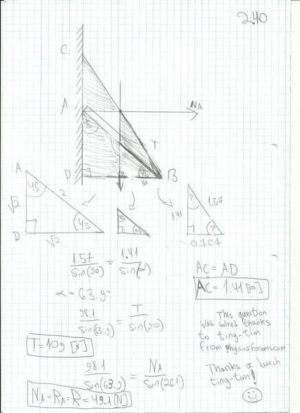

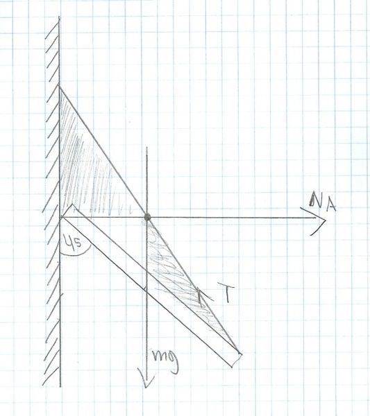

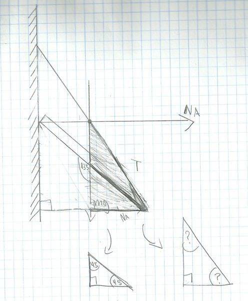

I can't get to the point of 3 equations and 3 unknowns because I don't have AC and I don't have the angle...here, look, this is where I keep getting stuck at:
Sum of all moments on A = 0 = T(sin alpha) x 1.41 - mg x 1.41/2 = 0
Sum of all moments on B = 0 = -NA x 1.41 + mg 1.41/2 = 0
Sum of all moments on mg = 0 ; -Na(cos45) x 1 + T(sin alpha) x 1 = 0
I don't know how to include AC is one of the unknowns...regardless, since the angle is also an unknown I don't see how can this be solved...
