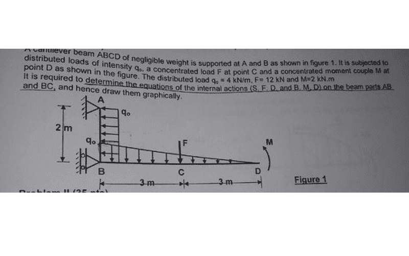

Statics of structure, distributed load
In summary, the person is asking for help with a problem involving two confounded loads. They have calculated the reaction forces at points A and B, but are unsure how to work with the section where the two distributed loads are confounded. They mention an L-shaped beam and a diagram that may imply a linear decline in the horizontal load. The person is seeking clarification on the problem and is unsure if the issue is with the combination of distributed and point loads or the mix of vertical and horizontal loads.
Morshed awad
All data are in the image uploaded
I don't know how to deal with two confounded loads
I really need fast replies thnak for your attempt

This is not a very difficult problem . You should really have made some effort to solve it yourself .
Start by working out the reaction forces at points A and B . Show us your workings . We'll go on from there .

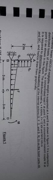

Yes i have calculated the reaction forces but the problem tha i don't know how to work with the part wherethe two distributed load are confounded please lead me and i just want to know about the section thank u
Not sure I understand the diagram. It seems to be an L shaped beam, assumed rigid at the bend. The distributed load is of uniform density q0 on the vertical section, but what about the horizontal section? The text suggests that is also uniform, but the diagram implies it declines linearly(?) from a max of q0 to zero at the tip.
By "confounded" loads, do you mean the combination of distributed and point loads on the same beam section, or is it the mix of vertical and horizontal loads that bothers you?
