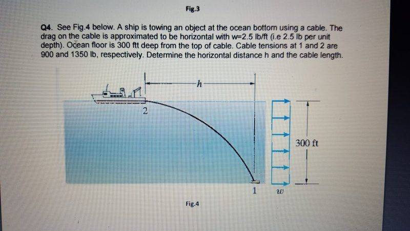

can someone please help and explain to me how to do this problem? all the data is in the picture above.
i am not entirely sure which equations i should use. i know one possible equation is T=((T_o)^(2)+(wy)^(2))^(1/2)
with the one equation that i know, i can say that point 1 is not the bottom of the parabola.
past that i need help
Any help would be appreciated
i have been stuck for about a day and a half and just don't know where to start.
Thank you so much
I haven't tried to solve it all (not sure I can) but try drawing a free body diagram for the rope showing the horizontal forces. I think it's possible to work out the angle the rope makes at the bottom if that helps.
Likes ThewyBenner
You know the forces at the ends of the cable. You know those forces are tangential to the cable ends. You know the drag. That makes 3 forces. If they are in equilibrium they must all meet at one point. You don't have enough information about the cable self-weight to take account of that. Can you do it graphically with a triangle of forces?
