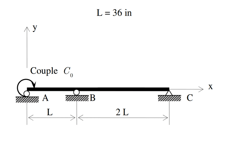

I have to solve for Ay, By, and Cy reaction forces. The constant C is a couple acting at A in a clockwise direction
Sum of all forces = 0
Sum of Moments about any point = 0
I solved for all four reaction equations(one force sum and three moment equations at a,b, and c) These are the four equations I calculated:
Ay + By + Cy = 0
36(By) + 3(36)(Cy) = C
2(36)(Cy) - 36(Ay) = C
-3(36)(Ay) -2(36)(By) = C
But no matter how I try to solve the system of equations I always get 0 = 0 or a singular matrix. I don't know if the problem is that I messed up with one of the moment equations or if there is something else I need to do. Any help would be very much appreciated, thanks!

This beam is statically indeterminate. You can write only two equations of static equilibrium, but you have 3 unknown reactions to solve for.
You'll have to find a third equation to use which doesn't involve the sum of the forces or the sum of the moments.
https://en.wikipedia.org/wiki/Statically_indeterminate
