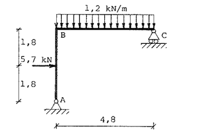

I need to calculate the internal forces M3, V3, and N3 for a specific section of a structural system. The known reaction forces are:
  • R_AH = -5.7 kN
  • R_AV = 0.7425 kN
  • R_CV = 5.02 kN

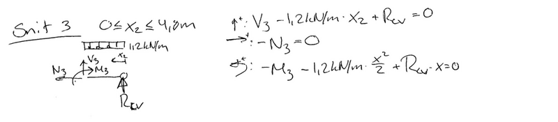

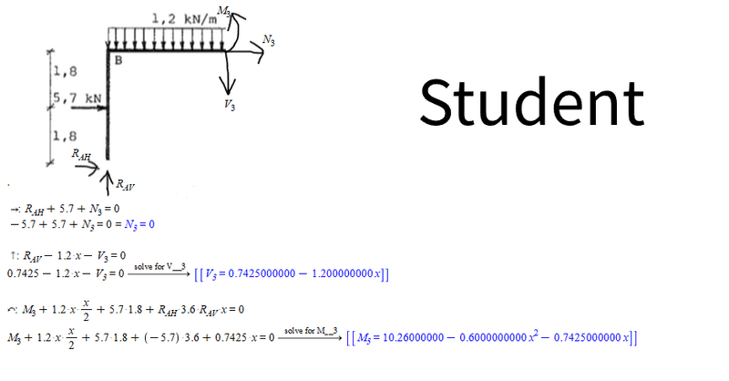

Two different sections have been analyzed: one on the left side of the cut (my choice) and one on the right side (analyzed by my teacher). I have attached both my calculations and my teacher’s calculations, as well as an image of the static system. My image is labeled with "Student" and shows my approach.
Could someone please review the attached calculations and images and help verify the correct values for M3, V3, and N3? Any insights or corrections would be greatly appreciated. Thank you!

Welcome, @YNH ! :smile:
First things first: A clear and precise free body diagram should be the very first step when trying to solve problems of this type.
Otherwise, trying to solve even the simplest problem may lead to errors.
Please, go over the signs of your equation of moment at cut section 3.
As the values of the reactions are given, you could verify the accuracy of each solution (right and left approaches to cut section 3) simply by substituting x by the 4.8 meters value.

The difficulty that I see:
Not all the signs in your equation of moments balance are correct.
Note how your teacher shows the positive directions of forces and moments in his solution, and follows that convention with his equations.

I have now checked my signs for the equation of moments balance and have now the equation
[M][/3]+1.2*x*(x/2)+5.7*1.8+(-5.7)*3.6-0.7425*x
can you point out what is wrong and also our equation for the shear force is also wrong what is wrong there?
That is not an equation (it is missing =0). :wink:
Summation of all the clockwise moments (about the cut section) = Summation of all the counterclockwise moments (about the cut section)
