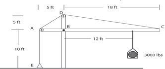

The horizontal member ABC of the rig shown below weighs 1000 lbs and is supported by a pin B and cable EADC. Since the cable passes over pulleys at A and D, the tension is the same along the entire length of the cable. If the rig lifts 3000 lbs at a distance 12 feet from the vertical member DF, determine
a) the tension in the cable, and
b) the horizontal and vertical components of the reaction at B.
I know you have to use the sum of the moments in both x and y directions = 0 because it is in equilibrium, but I am not sure where to go from there

Might help to post the picture. The two rules of statics are:
1. Sum of moments about any point must be zero
2. Sum of all forces in any direction must be zero (normally it's convenient to use coordinate directions)
Heres a photo, sorry about that
