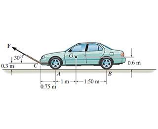

Apologies in advance if this problem has been brought here before, I searched and couldn't find it.
The automobile has a mass of 1.7 Mg and center of mass at G. Both the front and rear brakes are locked.
Take μs = 0.3
Determine the towing force F required to move the car.
ΣM = 0
ΣFx = 0
ΣFy = 0
friction = μs * normal force
The previous question to this was identical (although with different values), but with only the rear brakes locked. I summed the moments about A to find the reaction at B (normal force), and then multiplied that by the coefficient of static friction to find the frictional force, and solved for F using the horizontal force equation.
I tried the same approach for this problem. Summed the moments about A to find the reaction at B, and summed the forces in the Y-direction to find the reaction at A. I then multiplied those by the coefficient of friction to find their respective frictional forces. Then I summed the forces in the X-direction to solve for F. Wrong.
Clearly this approach is incorrect. Am I way off?
My thoughts are: the frictional force at A is greater than at B, will that have an effect? Does tipping somehow come into play in this problem?
Thanks in advance for any help you can offer. I tried to follow the guidelines, but I can show more work if need be.

It would be desirable to see your calculations for F.
The 16660 N is the 1.7*1000*9.8

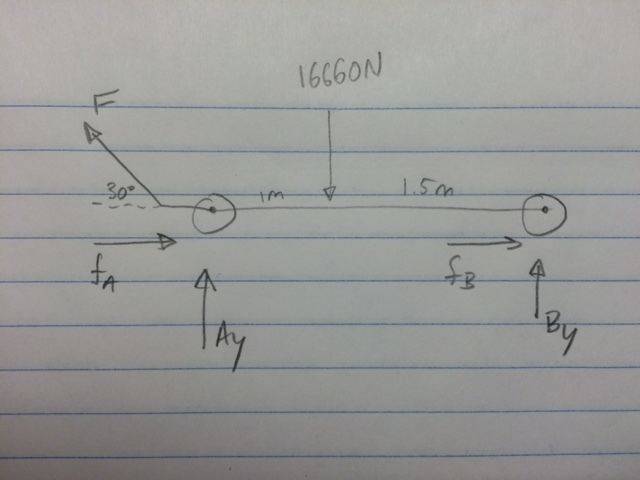

A term is missing from your ∑Ma = 0 expression and your ∑Fx = 0 expression.
Drawing a FBD may help...
I do have one, I didn't include it though. I'm failing to see what term I'm missing. I'm using the same technique for the problem I described initially, with the addition of the front wheels' friction. What other force is there to add to my moment equation without giving me too many unkowns? As for the ∑Fx = 0, what other forces are acting in this direction besides both the frictional forces and x-component of F?
Can someone explain why this problem might be different than the other one I mentioned?
(oops, the distance between A and where F is applied is 0.75)
Sorry, that was a typo, it should have been ∑Fy = 0.
Your FBD is correct.
Your moment equation is missing the moment about A due to 'F' and a similar term is missing from the ∑Fy = 0 equation
Can someone explain why this problem might be different than the other one I mentioned? View attachment 91877
Your original approach assumed that the force applied by the tow rope had no effect on the reactions at the wheels A and B.
Since the force in the tow rope has an upward component, the reactions at A and B in the towing situation do not have the same values as when the car is just sitting there.

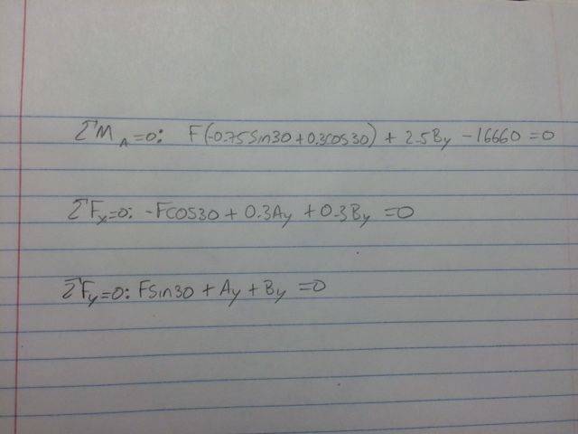

Ok, am I on the right track with these equations? I only have two more attempts to answer this so I can't risk it
EDIT: my vertical force equation includes -16660, I forgot to add it until after I'd uploaded the photo.
I would say you have approximately the correct approach.
However, the points of application of the reactions A and B, the towing force F, and the weight of the car G, are located at different points with respect to one another. I think you moment equation needs to be more general than you have shown here. You should use the vector form of the moment, M = r × F , here when writing the moments of the various forces about a common reference point.
I don't understand what you mean by more general. For the moment cause by F, do I not need to use both the components? If I use the cross product rather than what I'm showing here, I'm still ending up with the same answer for that... I'm sorry, It's been a very long day for me and it's hard to understand exactly what you're implying when you say that.
I'm not sure why I'm having such a hard time understanding only this problem. It's making me feel like I've never done statics before.
M = r × F by definition uses all components of r and F to determine M.
By 'more general', I mean use the cross product to calculate all the moments present in the free body of the car with the tow line attached.
Are you? You can't know that until you make the calculations.
Alright, I ended up getting it correct, but this entire problem was really confusing for some reason, and I'm still not sure I actually understand it completely. Thank you both for helping me (or at least trying to). I'm going to talk to my professor in the morning when my brain is actually functioning at a normal level and see if I can really get a grasp on it.
