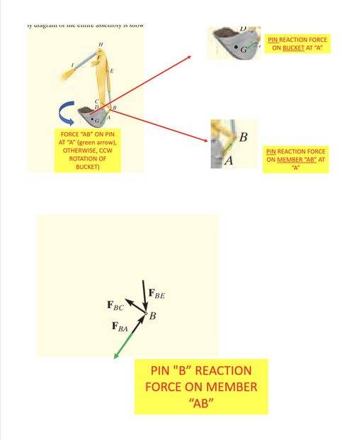

In summary, the book states that there is an external moment when the weight of the bucket is supported by the ground, and that this moment is prevented by the member AB pushing back against the link BC.

So, for the link "AB"...they didn't directly list the pin reactions from pin "A" here, but I want to be sure that I understand what those reactions are. So, from what I see in this image, the member is pushing at the pin "A" (red arrow) because otherwise, the bucket would want to rotate counterclockwise (blue arrow). That means that the pin "A" reaction on the member "AB" is also pushing back against member "AB" (green arrow), so it's a two-force member with compression forces at each end. I THINK the book is showing the same thing, because if you look at what they have for the FBD of pin "B", they have the member "AB" at "B" pushing against pin "B", so the reaction from pin "B" will push back against it; just like pin "A" does.
Is this correct? I have another question about how this book drew the forces, but I’ll ask after I clarify this…
Your description is correct.
The weight of the bucket has to be supported by the ground; the mechanism is just a chain that connects bucket and ground.
As the links AB, AE and BC are articulated, each can only support compression or traction loads; none will be subject to external moments.
If you can imagine that each link has some degree of elasticity, you could visualize links AB and AE getting shorter and link BC stretching, as it prevents pin B from moving too much to the right.

Thank you for your response.
There is a moment about point “D” though, right? Because like, if you were to remove the link AB, that bucket would rotate around “D” in the CCW direction. So the force from the member “AB” is preventing the moment about “D”, but member “AB” still does not experience an external moment. Am I saying this correctly?
Lastly….about the pin “A” reaction forces on the BUCKET. To satisfy Newton’s third law, the reaction forces on the BUCKET are in the OPPOSITE direction of the reaction forces on member “AB”, correct?

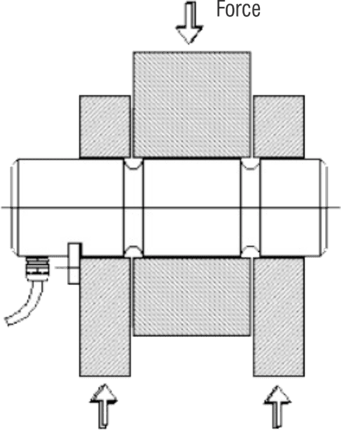

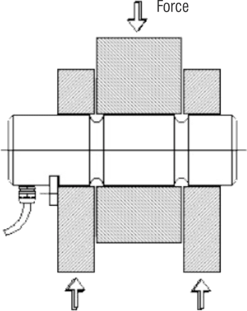

There is actually a shear load on pin A.
Two cross sections of the pin are resisting the efforts of the two pin housings of the bucket and the pin house of link A to shear them off.
When the bucket is full of sand or dirt, that shear load increases much more.
Right, I see that: the bucket and the link AB are trying to shear the pin by pushing on it in opposite directions at the ends. But because the pin obviously doesn’t shear, there has to be a pin reaction force on both link AB and the bucket, right? And these two reaction forces are opposite to each other due to Newton’s third law, right?
