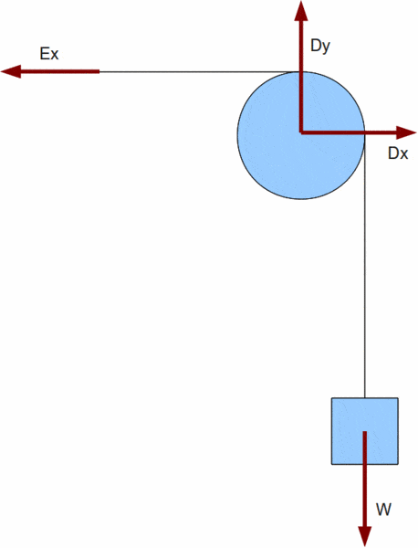

Can you say what the forces will be at E and at D due to the cable with weight W attached?
Ex = Dx
Dy = W

There's an additional rule about cables.
In a cable the size of the force (called "tensile force") is the same at any point in the cable.
More specifically, Ex=W.
[edit]So can you set up the sum-of-moments in the rigid system now?[/edit]
