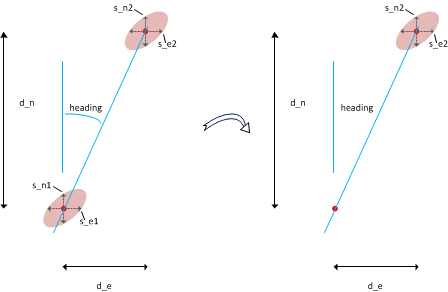

Find the formula for the standard deviation (s_h) of heading angle, given the north and east standard deviation of position of two points (s_n1, s_e2, s_n2, s_e2), each point's north-east covariance (s_cov_ne_1, s_cov_ne_2) and the north and east distance between them (d_n, d_e). Simplify the problem by assuming that point 1 is known and therefore has zero standard deviation. Heading is defined as the angle from north from position 1 to position 2.
heading = atan2 (-d_e / -d_n) ← this is given in the question. (atan2 not atan squared)

My perception is that the complicated situation is simplified as follows:
where the pink ellipse indicates that the covariance is > 0.
As per the first post:
I don't see a ##cov_{e1e2}##, a ##cov_{n1n2}## or a ##cov_{d_ed_n}## in the first post, only a ##\ s\_{\rm cov}_{ne1} \ ## (which is assumed to be zero) and a ##\ s\_{\rm cov}_{ne2} \ ##.
The simplification let's ##\ \ s_e = s_{e2}\ \ ## and ##\ \ s_n = s_{n2}\ \ ## be the uncertainties in ##\ d_e\ ## and ##\ d_n\ ## and ##\ s\_{\rm cov}_{ne2} \ ## the covariance of these uncertainties. Still, the big "Then ##(\triangle f)^2=...##" expression is correct (when you substitute the given ##\ s\_{\rm cov}_{ne2} \ ## for ##\ cov_{d_ed_n}\ ## )
-- and that ##\ s\_{\rm cov}_{ne2} \ ## is not zero !​
