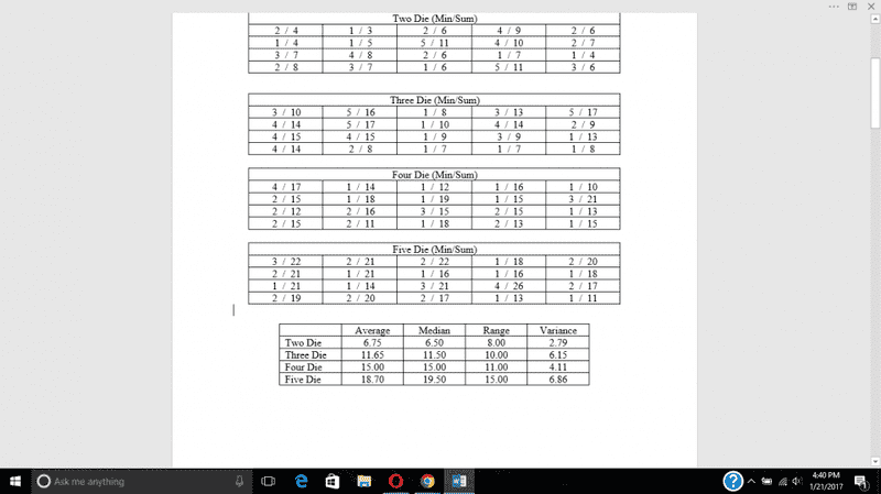

I generated data for a dice experiment. For the first case, two dies were rolled and the minimum number and the sum were recorded. For the other cases with three, four, and five dies, the minimum and sum were also recorded. I attached a picture of the tables with my data and the calculated average, median, range, and variance.
Are there any patterns present in the calculated average, median, range, and variance?

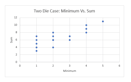

I also attached a picture of a graph I made in excel.
Are there are any patterns present when you plot the min vs the sum? I would think not since dice rolling is random? But the way my professor asked the question makes me think there should be one appearing somewhere.
In the graph I attached, if you subtract the amount of data points in the second row from the first row, you get the amount of data points in the fifth row. Subtracting the third from the first you get the fourth row. But is this a pattern?

OK. So describe the graph to me.
Looking at the n=2 graph of S vs L you supplied, what happens to the number of data points as L increases?
What is the trend there ... as L increases S gets bigger/smaller/stays the same (pick one).

Oh, it looks like the number of data points decreases for the most part as you move along the positive x direction. And it looks like the sum is a lot higher when you have a larger minimum? I hope I understood your question correctly.
Well done - are those not patterns?

Haha it might be because originally when I plotted the graph I connected all the dots and saw that the line connecting them was all over the place. That made me think it was random. I guess for this experiment it doesn't make sense to connect the data points.
