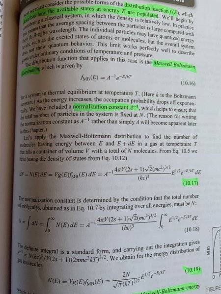

Another question regarding my attempt to solve this problem: Why does the Bolzmann energy distribution only tells me the kinetic energy? Can you give me a hint where in derivation of the energy distribution (picture) the kinetic energy gets in?
I appreciate your help!
The Boltzmann energy distribution just tells you that occupancy is proportional to ##e^{-E/k_BT}## - it is valid as long as your states have low occupancy so quantum effects do not come into play. The Maxwell-Boltzmann distribution is what you were trying to use. It is the distribution of velocities given that the kinetic energy is given by the classical mv^2/2. Changing some variables you can find the density of states expressed in different variables. However, in this problem, you are not at all interested in the distribution of velocities, you are interested in the internal degrees of freedom of the molecules. If you were interested in the full distribution function (in terms of both velocity and internal states), then it would be given by the product of the Maxwell-Boltzmann distribution and the distribution function of the internal states.
See https://en.wikipedia.org/wiki/Boltzmann_distribution versus https://en.wikipedia.org/wiki/Maxwell–Boltzmann_distribution
