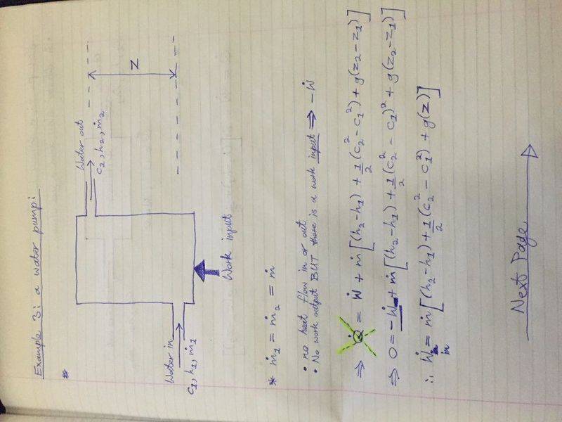

I'm not too sure about my attempt to this question, but what is the simplified Steady Flow Energy Equation for a water pump that has one inlet at the bottom and one outlet at the top, and a work input?
Q^ = W^ + m^[(h2 - h1) + 1/2 (c22 - c12) + g(z1 - z2)]
I have attached a picture of my attempt to the solution to this thread.

My attempt to the solution along with the picture of what I'm talking about is attached too...as well as the steady-flow energy equation that I need to be simplified for this particular situation.
Is my simplification correct? If not, please advise further
Yes. It looks like what you did is correct. With regard to the Δh, don't forget to include the Δp/ρ term.

@Chestermiller , okay, but isn't that already included, as h = u + pv ?
Yes. But some people would have just written Δh=CΔT. Since I don't know you, I was unaware of whether you might make that mistake.
