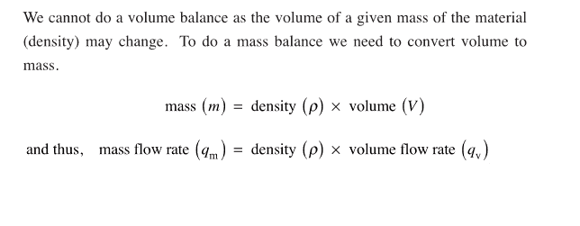

The symbol q is usually used for volumetric flow rate. In the mass balances, you should be using mass flow rates F, T, and B.
I am struggling with the enthalpy.
The equation I have been given is:
Q = qm(To - Ti)I don't recognise this.
Qh = qmbCTb + QC + qmtCTt - qmiCTi

in the mass balance I should have used qm.
in the information i have been given qm = mass flow rate qv = volume flow rate
X = specific heat capacity where I use C
all the examples i have been given do not show any integration.
If the heat capacity is a function of temperature, you need to integrate with respect to temperature to get the enthalpy. Didn't they cover this in your thermo course?
