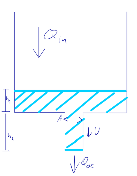

This is not homework, but something work-related. However, I will post it here since it's homework-relatable.
1. Homework Statement
Known variables: Qin , A (and obviously the diameter D of the pipe as well as g = 9.81 m/s2).
The pipe outlet and the top of the tank is at atmospheric pressure.
I want h1 to be as small as possible.
What I'm looking for is an expression for h2.
For the moment I'm assuming zero pipe friction.
2. Homework Equations
Torricelli's law (v is the same as U):
Q = U*A
Might be more?
In steady state, Qin and Qout are equal (=Q)
I tried solving for h using the two equations above and got
h = Q2 / (2*g*A2)
Is this h h1, h2, the sum of h1 and h2 or neither of these things?
Is this even the right way to approach this problem?

I'll try a different hint. At what points are the pressures known to be equal?
Let's apply Bernoulli's equation at 3 locations:
Point 1: The top of the fluid in the tank where the pressure is atmospheric Pa. If the datum for potential energy is at the outlet of the pipe, what is the ##\rho g h## at this location? What is the velocity at this location?
Point 2: The top of the outlet pipe, at h=h2. Call the pressure P at this location. What is the ##\rho g h## at this location? What is the velocity at this location?
Point 3: The outlet of the pipe. What is there pressure here? What is the ##\rho g h## here? What is the velocity at this location?
From this assessment, write out Bernoulli's equation for points 1 and 3, and then for points 2 and 3.

None of this was correct.
Point 1: ##p_a+\rho g (h_1+h_2)+0##
Point 2: ##P+\rho g h_1+\rho \frac{v^2}{2}##
Point 3: ##p_a+0+\rho \frac{v^2}{2}##
So, from Point 1 and Point 3, we have: ##p_a+\rho g (h_1+h_2)+0=p_a+0+\rho \frac{v^2}{2}## or $$v=\sqrt{2g(h_1+h_2)}\tag{1}$$
From Points 2 and 3 we have: ##P+\rho g h_1+\rho \frac{v^2}{2}=p_a+0+\rho \frac{v^2}{2}##. This gives:
$$P=p_a-\rho \frac{v^2}{2}$$
This equation indicates that the pressure at the very entrance to the tube is below atmospheric. So, the tube is sucking fluid out of the tank. That's why Eqn 1 has h_2 included in the total height of water responsible for the velocity.
Note that this analysis is valid as long as h1 is large compared to the diameter of the tube. If it is not, then the velocity at the upper surface is non-uniform (disturbed by the presence of the tube), and our equation for the upper surface is no longer valid.
Chet
Likes kartmaze
