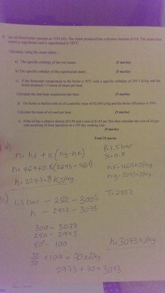

This is from a practice mechanical science exam for HNC engineering.
See attachment for the question sheet off a practice exam. I have no idea how to do this after the a and b parts and my answers for which are below the question (underlined), any suggestions or solutions would be greatly appreciated.
Q = M*c*(Temperature Difference)
I think...

You should double check your calculations for parts a) and b).
According to the problem statement, the boiler operates at a pressure of 1050 kPa. {At least, that's what I can read from the tiny image attached.}
Your solution for part a) says that the properties of saturated steam are for at pressure of 1.5 bar.
Your solution for part b) appears to be using the enthalpy of superheated steam at a pressure of 1.5 bar.
What's the definition of a bar?

Ah I see my mistake with the answer now, 1050kpa would be 10.5 bar not 1.5 Bar
1.5 bar is 1.5x10^5 pa or n/m^2
Will correct mistake, input correct figures for h and include a better image...
