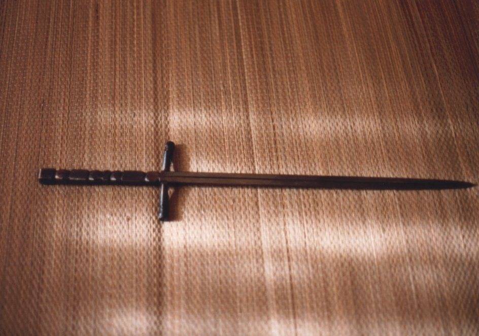

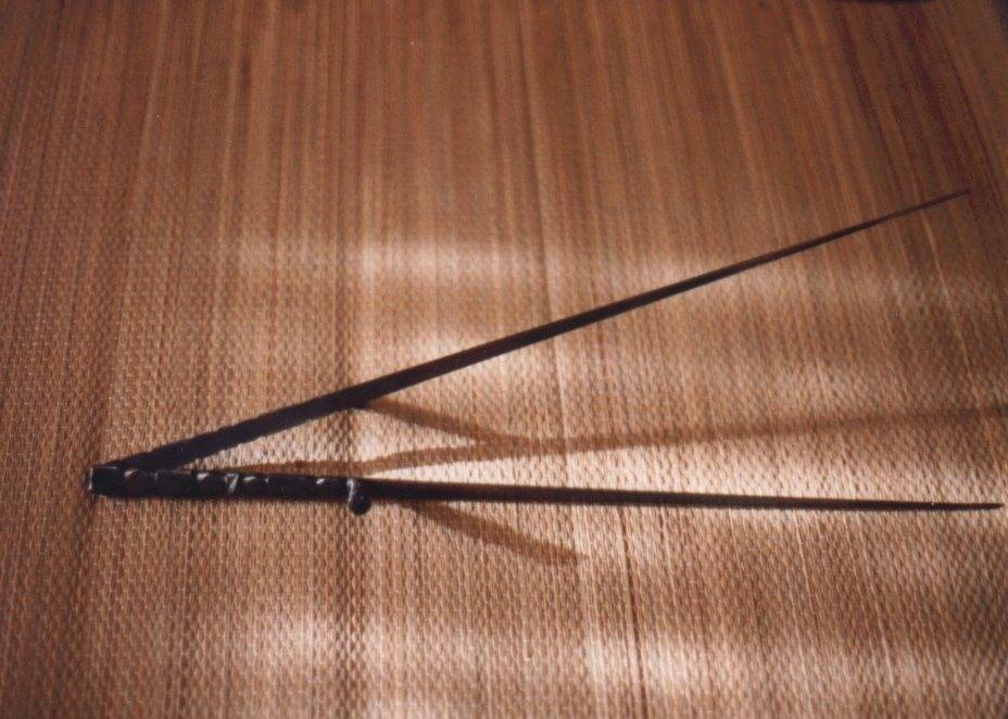

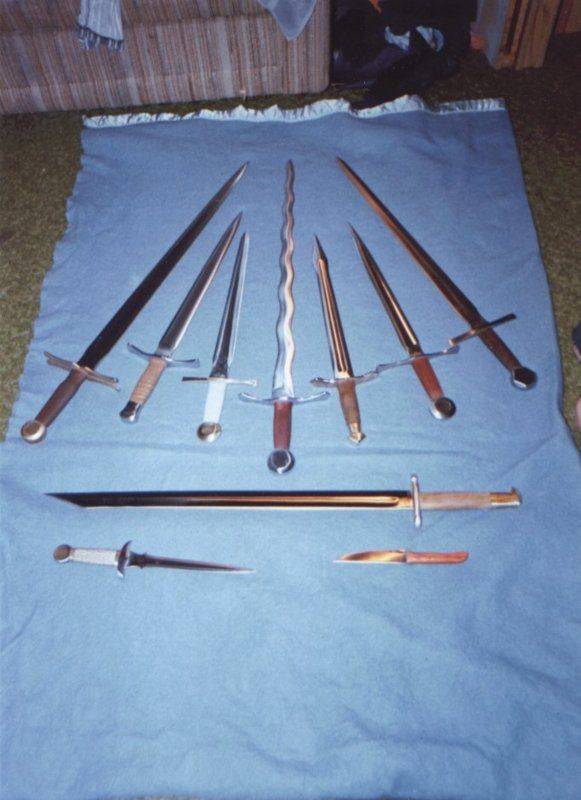

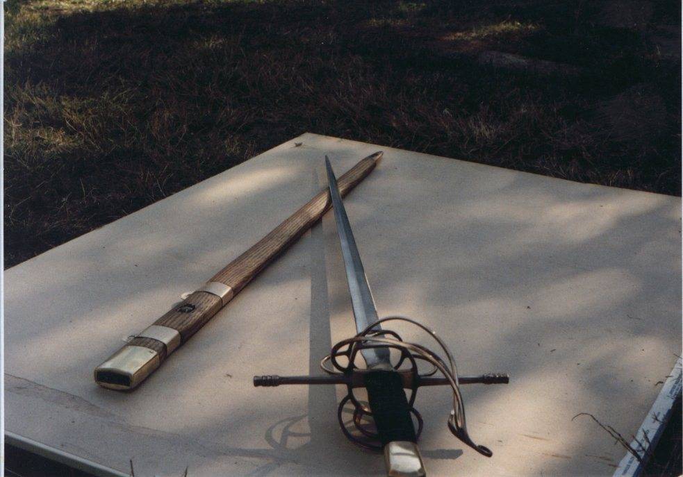

Being a historical weapons and armor builder, with a LOT of experience not only in making swords, but in the use of them, as well as having had a father who was a cabinet maker as well as UDT SEAL, so I learned a lot about weapons use and materials etc.
The skull shown on the original paper and NYTimes article appear to be made strictly from the saber-like Wonna, a wooden throwing stick that was also essentially a battle axe if used in hand. Seeing pictures of the weapons possible involved I have to say that with the materials there in the area, where flint and obsidian are extremely rare, mostly being sedimentary type stone for large areas, wooden implements and the specific technology of treatment, fire and plant extracts to harden the material, and having handled some of these implements myself I will state that I find the wounds on the skull in question do not look like wounds that would have come from a metal sword.
They have more the appearance of fast, light impact without the 'carry through' that a dense metal blade would have had, especially in that area for a cut and the fact that there are no other 'cut' marks on any of the bones, especially lower arm defensive wounds. Their description of the 'wonna' a fighting boomerang, makes if fairly clear that was the likeliest weapon to make that wound. Splintering etc on a high-speed impact like that can remove chunks of bone fairly cleanly and even softer wooden implements, used at high speed, can do that kind of damage, high speed being either full man's throw or swing to kill. A hardened chunk of Australian Ironwood will do massive damage.
The reason we do not use wood for knives is their fibrous nature and no edge-holding ability, but the wood is tougher than many metals and not as brittle as most, and lighter so it can be moved at speed. With a weapon speed is more important for a cutting weapon than mass because of the E=M x V^2 with more energy coming from square of speed vs linear of increase of mass. A lighter fast weapon can do more damage than a heavier slow weapon.
Chisels are also for controlled cutting, usually shaving the bone in increments (I well know having had full 2 level fusion at C5-6-7 with multiple laminectomie, which is Why I am no longer making a living building swords.) And when cutting bone or wood with a chisel it is very different than a massive, high energy swing with a sharp club so as to make the comparison not at all comparable.
The hockey puck would do similar damage blasting out a chunk like that even with a 90 degree corner. Without the missing chunk of bone and seeing if it was cleanly split off or shattered would make the determining difference, as well as finding a metal sword in that geological strata and area, or proof of their existence. Without such I think we have to go to the Occam's Razor view of the Wonna being the most likely weapon to cause that damage as it was the indiginous weapon at the time, and the other injuries do not show any sort of edged weapon type marks, and if there was a fight with a sword involved, like that, it would be more evident on Other bones, such as the ribs, which appear to have more of a blunt force trauma to them. The arm injury I am ambivalent on as it could easily be a spalled piece from dull impact, and there is no evidence of edged cut on it even though it appears smooth and conchoidal.
Obviously the individual had survived heavy head wounds before, as there is the healed scars from previous injury to the head. But it looks like the wound to the right side of the skull likely taking out the eye is what killed this man. And it appears to be high speed, low mass impact due to the way the conchoidal edges of the thin side of the flake removed and the apparent crushing of the bone directly under the 'end' of the cut and the piece apparently shattered out of the wound.
But I see no reason to think that it would have been a metal weapon, although there is the distinct possibility of lost sailors having been cast ashore there in Australia, possibly with swords etc, well before Western Colonization. So while there is the slim Possibility of there being a metal sword there the likelihood of it is Low, so I am going to have to back the view that the wound was made by a hardened wood wonna at close range.

I have Built wooden swords as well as steel ones and bronze, the wood would do exactly that kind of damage, especially the Aussie Ironwood varieties that are used. A pig skull has very different morphology and is NOT a good example of how Human skull would chip/cleave.
While there IS the (Note the exact wording) Possibility of there being a sword in the area, the Likelihood of there being one is extremely low. So, until YOU come up with actual PROOF that that was done by a metal weapon, I am going to continue to insist that that is a wood based impact wound on the skull, that it is chipped and conchoidally edged showing that it was split off from percussive force. That is not a 'sliced' piece, it is broken out of there. It is too bad the missing piece is not there as it would have told us a lot about how that wound was formed, but the wooden wonna appears to be the culprit.
