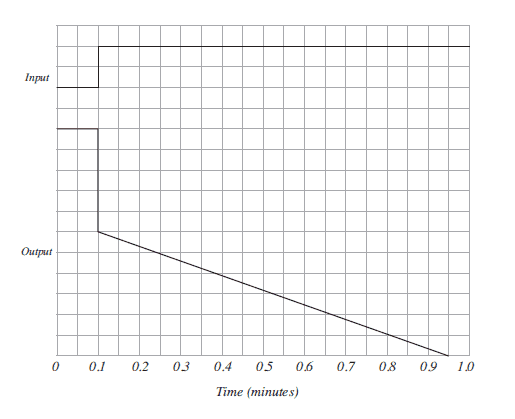

Figure 5 shows the input and output wave forms for a proportional plus integral controller. State:
(i) the controllers proportional gain
(ii) the controllers integral action time
The attachment below is a copy and paste of the input and output wave forms I am given
[/B]
I use the equation ##gain = \frac{100}{\%PB}##
Integral action time is the time taken for the initial change due to proportional action to be repeated by the integral action when the input to the controller is subject to a step change
I[/B] am looking at where to start with this as all of my lessons show the output moving in a positive direction (up) so do I assume this is some kind of reverse acting device as the output is moving down as the input increases.
There are no values given on the y-axis so I do not know ranges etc. In a situation like this, if I input my own values would should I still be able to calculate the correct values? I am just looking for a little bit of info to initially start me off in the correct direction
Well you have to work with what you're given.
I see input stepping UP two squares
and output stepping DOWN five squares
so i'd answer gain is -5/2 squares per square which gives gain = -2.5 and the units cancel.

rude man said:
So how about the integral gain?
Some manufacturers apply proportional gain to integral action, some do not.
It depends on whether or not their internal error term gets multiplied by gain before applying integral.
In his graph,
output wasn't integrating before the step change at input, so error then must have been zero.
After the step we can assume there's an error of two squares.
Output changes by an amount equal to error, 2 squares, in 0.28 minutes so that'd be the integral time in some makes of controller.
Output changes by an amount equal to error X gain, 5 squares, in 0.7 minutes so that'd be the integral time in other makes of controller.
Which did his textbook assume? He didn't say.
In my experience the latter is more common but far from ubiquitous.

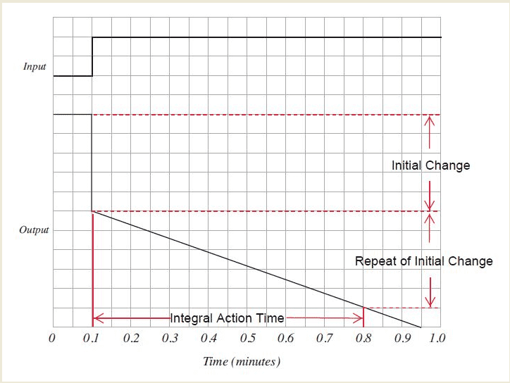

I dug deeper into the lessons and discovered another method of calculating the gain which makes far more sense and agrees totally with Jims post number 2
##gain=\frac{output change}{input change}## so ##gain =\frac{-5}{2}=-2.5##

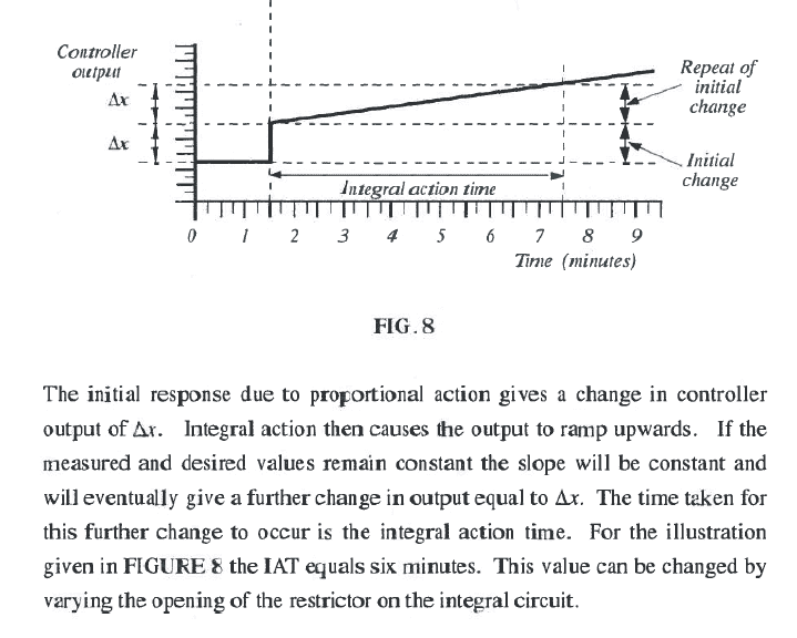

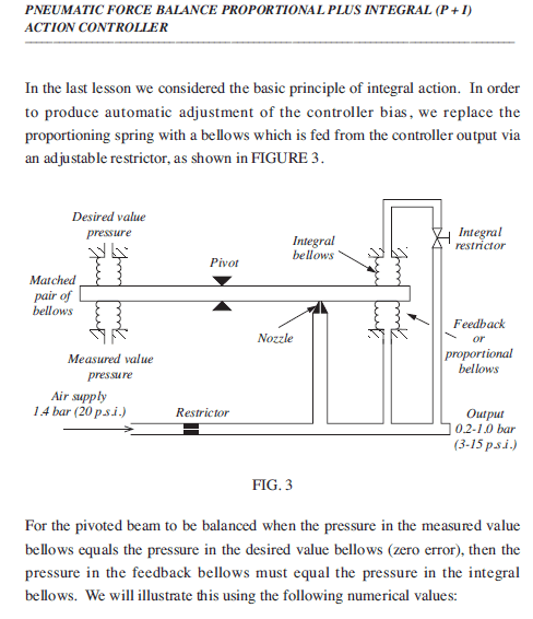

I also found an example of the Integral action time in one of the lessons and its explained quite well (I need to read more into these lessons) I have attached an extract from the lesson below.
Based on the above I am certain that the correct value for Question (ii) will be 0.7 seconds

"...opening the restrict or on the integral circuit..." ??
Wow that sounds like a pneumatic controller - you'll find excellent training materials in old Bailey and Fisher literature .
Integral of a constant is a ramp , ∫kdt = kt (plus Constant of integration) and C is just whatever output was when integration began
Derivative is also called "Rate"
and as name implies it's derivative of error
your ramp is a constant rate of change so derivative will be its rate of change .
Yes, its a Pneumatic force balance controller. This is the example they use through all of our modules

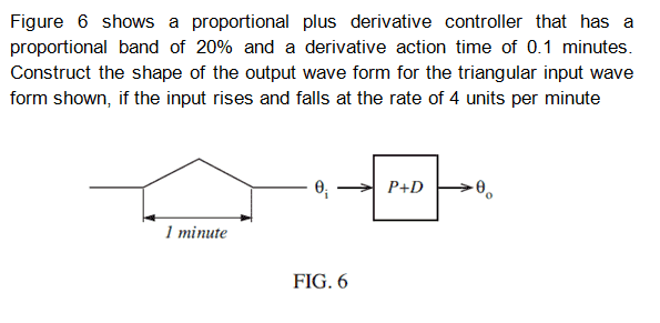

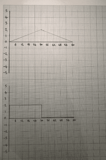

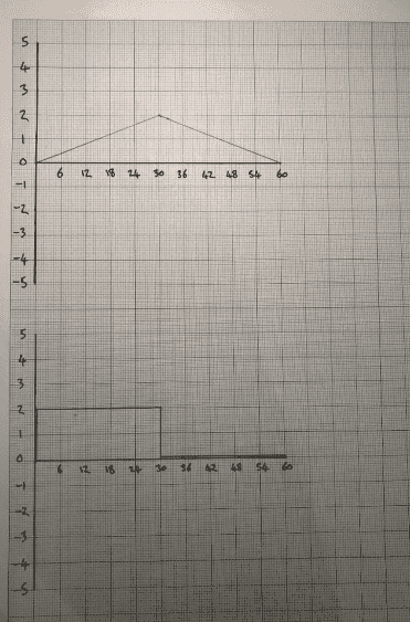

Going back to post 6
This question only asks me to actually create a waveform. If it rises and falls over 4 units per minute then it must start at zero and reach its peak after 2 units then back down to zero when it reaches 4 units. As shown in the drawing above.
I have made a drawing below of what I think the output wave form should look like based on limited info I have in the lesson notes
Does this make any sense??

oops i missed your post 10 somehow. Sorry about that.
your plot looks almost right for the derivative part
but what about the proportional?
You could consider the two terms as separate computations then sum them.
derivative term should be the slope of input so steps at first positive then negative
and that is added to the proportional term , which i don't see represented in your second line

Hi DavidJ,
Sorry to resurrect an old post. Was this marked correct? From what I can tell it doesn't have the derivative action drawn?
Hello Jason
This was marked as correct. Its a long time ago now. I had actually submitted this for marking before Jim pointed out about the proportional but thinking back I did ask about this and was told it was not required
David J said:
Hello Jason
Hi David thanks for the reply. The questions just seem so vague sometimes! Thanks again.
